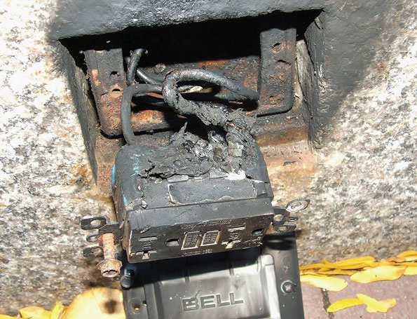

A customer called to complain that his outside plugs weren’t working. I found this disaster while troubleshooting this circuit. The receptacle wasn’t working, but, believe it or not, the circuit feeding this GFCI receptacle was still energized and supplying power to it. The receptacle was destroyed from arcing and sparking connections. Water and moisture had gotten into the box because the installer didn’t use the correct screws for installing the receptacle or the box cover.
In the photo, you can see the large hex head screws that were used for attaching the receptacle yoke to the box. Using these ridiculously large self-tapping screws is a violation of Sec. 406.5 because they were not the type of screws originally supplied with the receptacle, nor were they machine screws with 32 threads per inch. The same type of self-tapping screws was also used to attach the cover to the box. These overly large screw heads prevented the cover from seating properly on the receptacle, allowing water to seep in and destroy the receptacle.
Luckily, this was installed in a granite surface; otherwise, this could have become a real disaster if this were located adjacent to a combustible surface.
