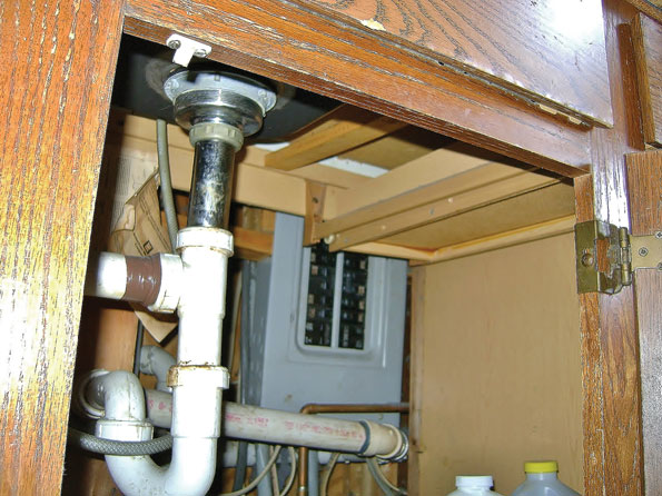

    Hide and Seek
    Now where could that panelboard be hiding? Oh, under the kitchen sink of course!
    This hidden surprise was sent in by George Parrish, an electrical inspector for the City of Hagerstown, Md. “Russ, I thought I’d share a photo I took while conducting an inspection,” says Hagerstown. “The previous owner converted a storage room to a kitchen. Enjoy!”
    How in the world are we supposed to gain access to this panelboard and the breakers? This is a blatant violation of Sec. 240.24(A), which requires overcurrent devices to be readily accessible. The lack of any headroom and safe working space also violates Sec. 110.26(A). And the plumbing pipes directly below the panelboard create a violation of the dedicated space requirements found in Sec. 110.26(E).
    The cover of the panelboard was probably torn off in an attempt to make the breakers somewhat accessible. But this missing cover now violates the intent of Sec. 110.12(B) because the mechanical integrity of the enclosure has been compromised. It also increases the chance of physical damage to the circuit breakers. Section 240.24(C) requires overcurrent devices to be located where they will not be exposed to physical damage.
