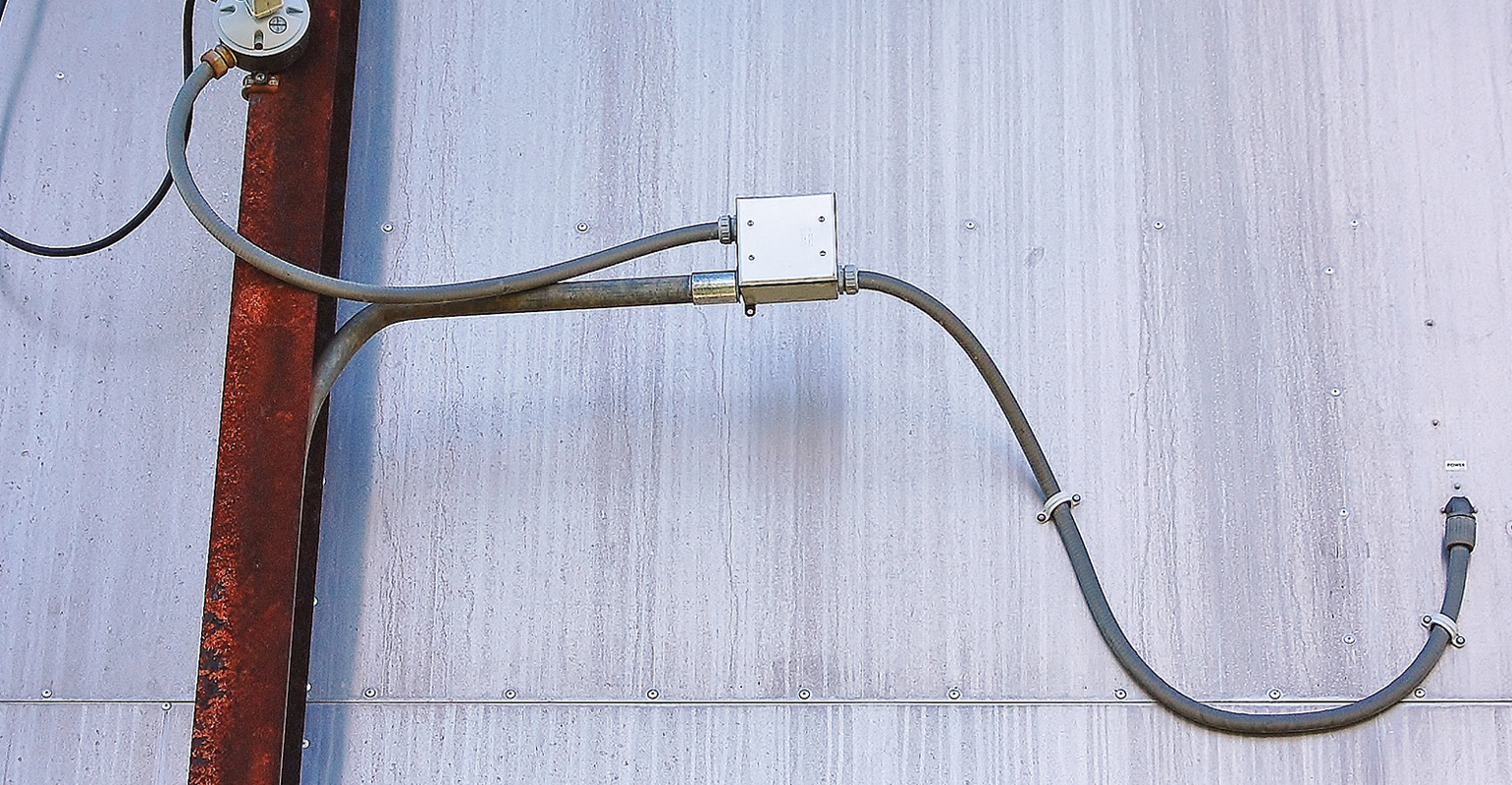

Athletic Non-Supporter
I spotted this arrangement on the backside of a scoreboard at a local little league baseball field. The installers apparently forgot about some of the support requirements for wiring methods and boxes. The liquidtight flexible metal conduit (LFMC) installed between the two boxes is completely unsupported, except for the connectors. Section 350.30(A) requires LFMC to be secured within 12 in. of each box and at 4½-ft intervals. There are four exceptions that allow alternative supporting options to this general rule, but none of those is applicable to this installation.
In addition, the weatherproof square box is not properly supported. The only reason it is not flopping around in the breeze is because of its attachment to the one rigid metal conduit (RMC). The LFMC provides no support for the box. Section 314.23(E) allows threaded RMC or intermediate metal conduit (IMC) to support this type of box, but the use of two conduits is required to support the box correctly. Using only one conduit is not considered a Code-compliant means of support. The RMC itself is not supported correctly either. Section 344.30(A)(1) requires the RMC to be securely fastened within 3 ft of the box.
