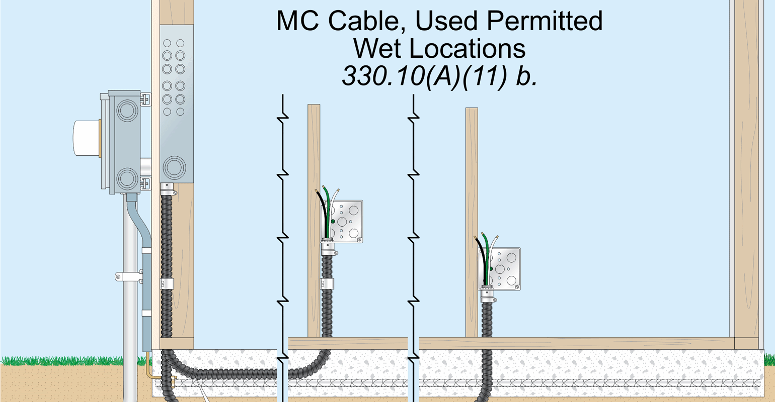

(11) In wet locations, where a corrosion-resistant jacket is provided over the metal sheath and any of the following are met: 
a. The metallic covering is impervious to moisture.
b. A jacket is provided under the metal covering that’s moisture resistant (Figure).
c. The insulated conductors under the metallic covering are listed for use in wet locations.
