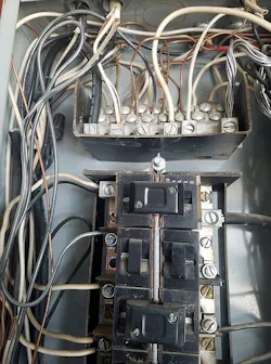

INATTENTIVE INSPECTOR
Another anonymous reader shared this photo with us. This work was discovered during an inspection of a newly purchased home. Apparently, the home inspector missed a few issues inside this panel. Starting at the top of the photo, we can see a white neutral wire doubled-up under the same terminal with a bare equipment ground wire. Doubling-up wires is generally a violation of Sec. 110.14(A), unless the terminal is specifically designed for it. The next violation, located on the neutral bus, is the small black branch-circuit conductor terminated on it. Using black insulation to identify a grounded neutral conductor sizes 6 AWG and smaller is a violation of Sec. 200.6(A). The larger black conductor on the neutral bus is probably the grounding electrode conductor (GEC), which is permitted to be black. Moving further down on the left, we can see a black wire and a white wire landed on the same top left terminal. Are these small wires being used in parallel? If so, this violates Sec. 310.10(H) because they are smaller than 1/0 AWG. You may notice several white wires landed on circuit breaker terminals. Using white insulation for ungrounded conductors is permitted only where the white insulation is re-identified to indicate its use as an ungrounded conductor in accordance with Sec. 200.7(C).
