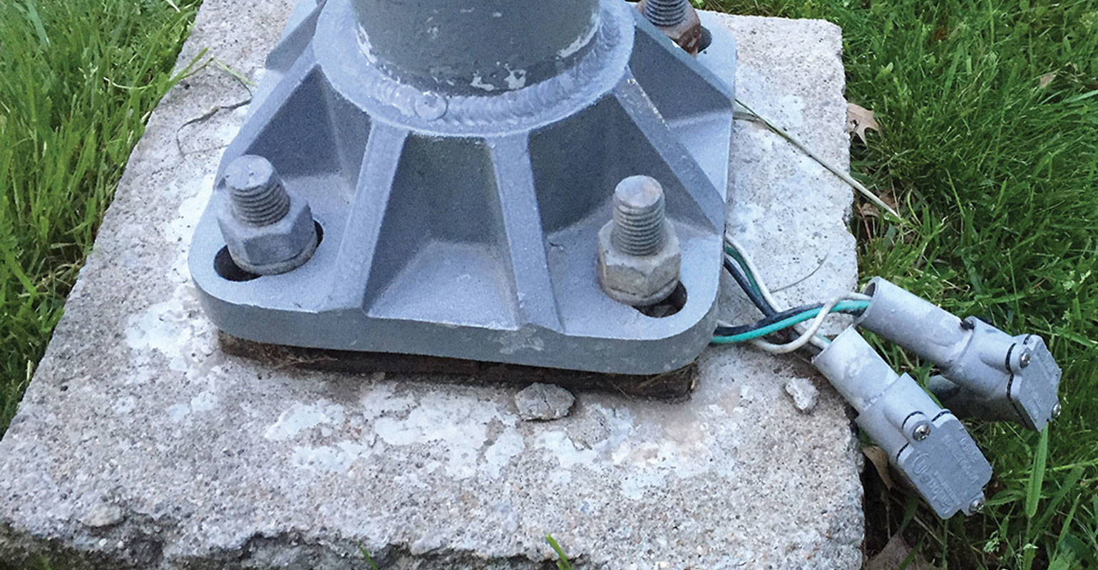

Pole Light Power Problems
This messy wiring was spotted in plain view along a public walkway. I am not sure what the back story is at this location, but I certainly know the tale it tells now. The PVC conduits are flopping around because the installer did not follow the rules in Sec. 300.11(A), which requires raceways to be “securely fastened in place.” Sections 352.30 and 300.18 require these raceways to be installed “complete between outlet, junction or splicing points prior to the installation of conductors.” Since this grassy area is subject to lawnmowers and weed whackers, Sec. 300.5(D)(4) and Sec. 352.12(C) require Schedule 80 PVC conduit to be used in place of Schedule 40 PVC conduit. The exposed, single-insulated conductors coming out of the PVC conduits are not permitted, and do not comply with Sec. 310.10 because they are no longer inside of a Chapter 3 wiring method. Since these conductors are also now exposed to UV damage from sunlight, Sec. 310.10(D) must be complied with. In this case, the conductors themselves must be listed as being sunlight-resistant or covered with an insulating material that is listed as sunlight-resistant. Some re-wiring is definitely needed here.
