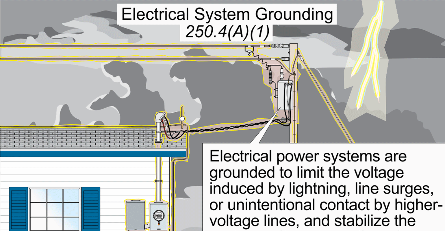

Q. What is the reason stated in the NEC for connecting electrical systems to the earth (grounding)?
A. Electrical power systems are grounded (connected to the earth) to limit the voltage induced by lightning, line surges, or unintentional contact by higher‑voltage lines and stabilize the system voltage to earth under normal operation [Sec. 250.4(A)(1)], as shown in the Figure.
System grounding helps reduce fires in buildings as well as voltage stress on electrical insulation, thereby ensuring longer insulation life for motors, transformers, and other system components.
