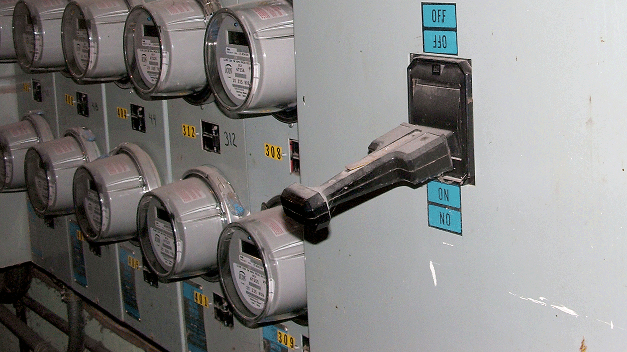

Which Way is Up?
At first glance, I thought this circuit breaker was turned off. Upon closer examination, I realized it was in the ON position, despite the handle pointing in the down position. There are even two sets of ON/OFF labels facing in opposite ways that add to the confusion.
For circuit breaker handles that operate in the vertical position instead of operating rotationally or horizontally, Sec. 240.81 requires the “up” position of the handle to be the ON position. This breaker is off when the handle is up and on when the handle is down.
It appears this circuit breaker enclosure may have been designed to be installed upside down as well as right-side up. Installing a circuit breaker in this position may have been permitted at one point, but it has not been allowed for a very long time. It can lead to a terrible mistake if the user is not paying very close attention to the ON/OFF markings on the enclosure. Can you imagine what could happen in an emergency if this switch was accidentally thrown into the ON position when the operator thought he was shutting it off?
