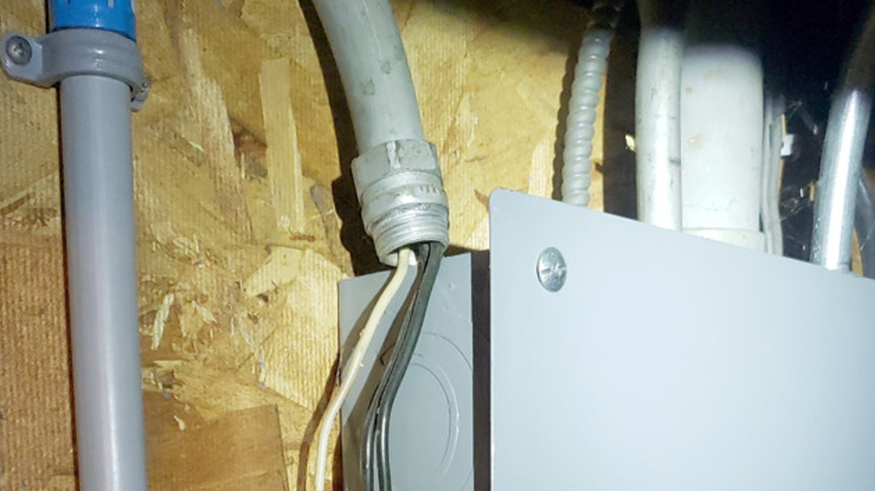

Thanks to Tim Rechek for sharing this photo. “I came across this panel at a house in North Fond du Lac, Wis.,” he says.“I was here to wire a new air conditioner. From the looks of what I saw, the panel was upgraded and rather than piping back into the panel, they just left the wires in free air — not to mention the PVC coupled with Smurf couplings. Clearly, this was a homeowner special. It amazes me what you come across on some service calls.”
Using ENT couplings (aka “Smurf” couplings because of their bright blue coloring) with PVC conduit is not permitted. While Sec. 352.48 requires joints between lengths of PVC conduit and between PVC conduit and couplings, fittings, and boxes be made by an “approved” method, Sec. 300.15 requires fittings and connectors to be used “only with the specific wiring methods for which they are designed and listed.” ENT couplings are not designed and listed for use with PVC conduit.
Another big problem is the conductors in “free air.” Section 310.10 requires individual conductors to be installed in a Chapter 3 wiring method. Section 300.10 requires the EMT raceway to be connected to the cabinet to provide effective electrical continuity. I could cite more violations, but I am limited for space on this page.Airing Your Dirty Laundry
