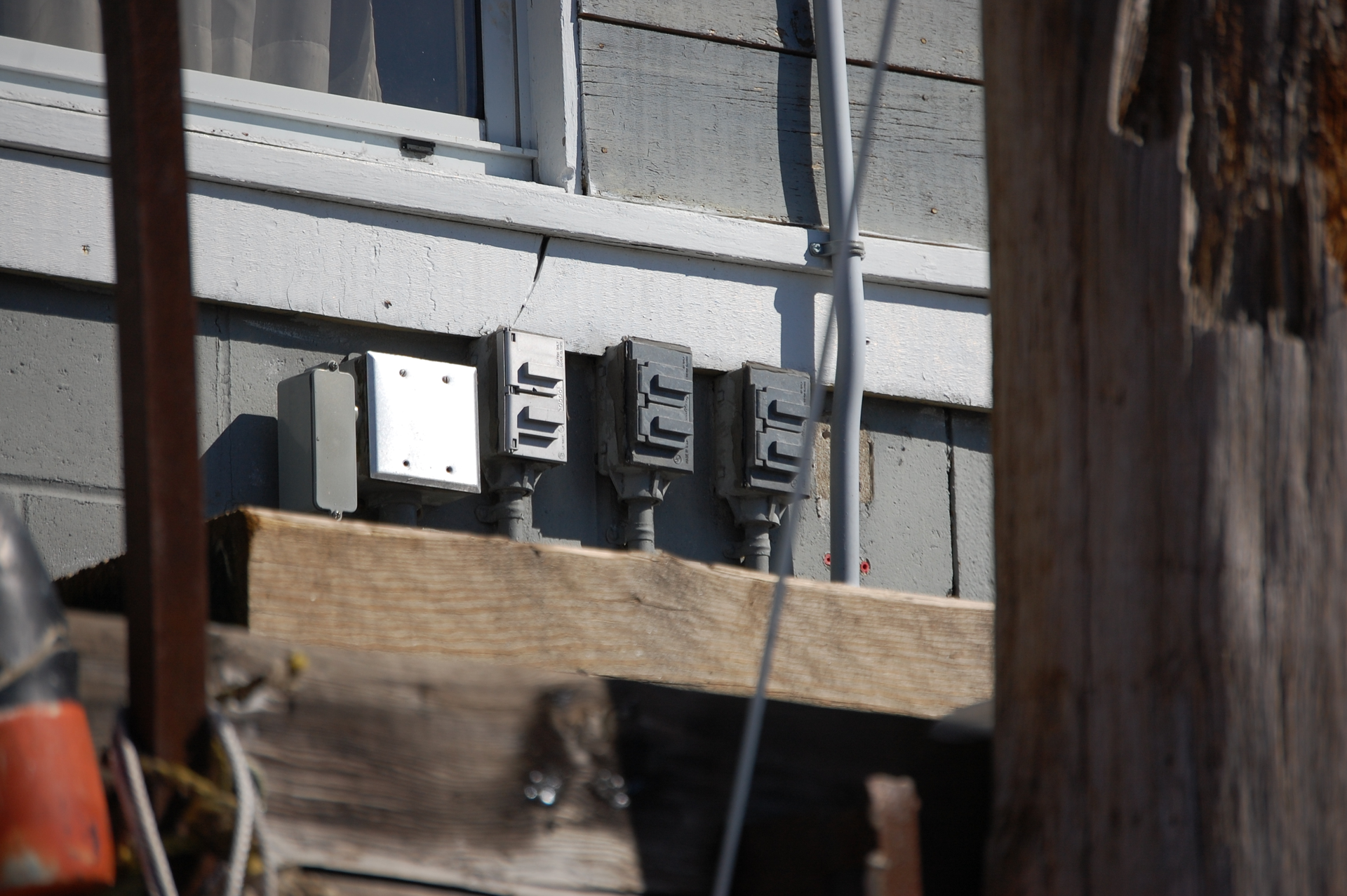

Which Way Is Up?
This installer apparently did not know which way was up when installing these weatherproof covers. They are designed to be installed so the cover flips “up” rather than being “left” to open. In this sideways position, these covers may not be able to keep moisture and water from entering the enclosures, potentially causing damage to any devices installed in the boxes. Failure to install and use listed or labeled equipment in accordance with the product instructions is a violation of Sec. 110.3(B).
For switches in wet locations, Sec. 404.4(A) requires weatherproof enclosures to comply with Sec. 312.2. In other words, the enclosures must be installed to prevent the entrance of moisture or water. For 15A and 20A, 125V or 250V receptacles installed in wet locations, Sec. 406.9(B)(1) requires enclosures to be weatherproof with an attachment plug inserted or removed. For other types of receptacles, Sec. 406.9(B)(2)(a) requires unattended receptacles to have a weatherproof enclosure with an attachment plug inserted or removed. Section 406.9(B)(2)(b) requires attended receptacles to have a weatherproof enclosure when the attachment plug is removed. Regardless of the types of devices installed in these boxes, the covers are not installed correctly.
