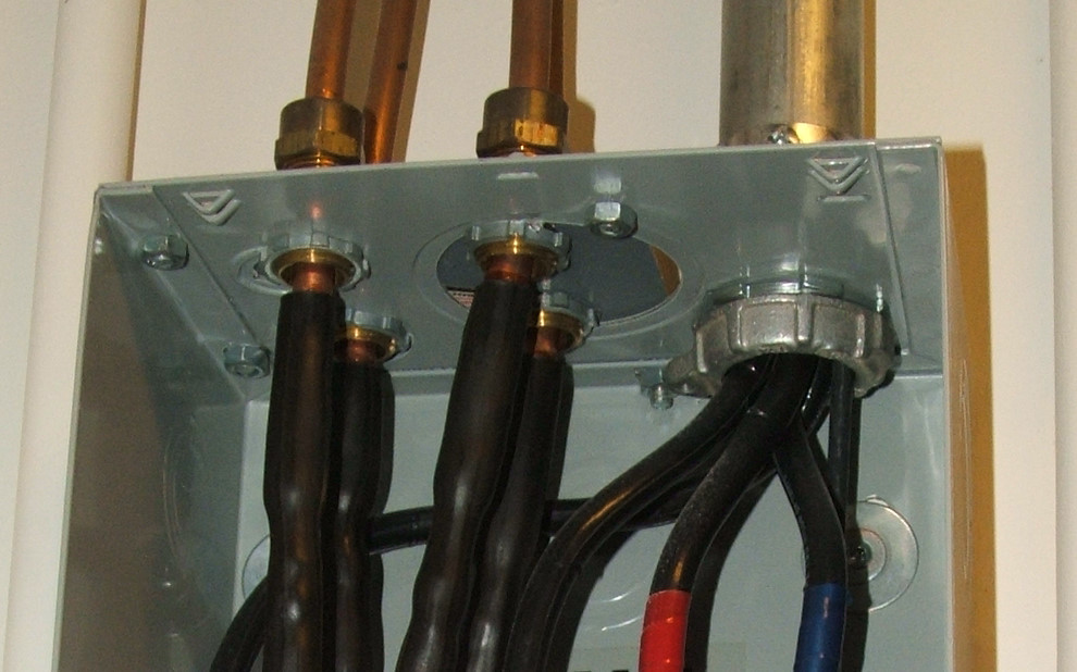

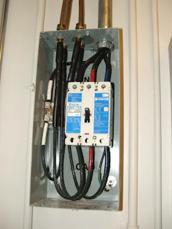

Separation Anxiety
A close look at the top left portion of this enclosure reveals the Code violations with this mineral-insulated (MI) cable installation. The installer brought each conductor into this steel enclosure through an individual opening without complying with the requirements in Sec. 300.20(B).When single conductors carrying alternating current pass through magnetic metal such as steel, the effects of induction shall be minimized by either cutting slots in the metal between the individual openings through which the individual conductors pass, or by passing all of the conductors through an insulating wall large enough for all of the conductors of the circuit. One common method installers use is to cut one large hole in the steel wall and then attach a nonmagnetic brass plate to the enclosure and then pass the conductors through this brass plate. This installer followed another path. He drilled holes in the enclosure for two of the conductors and then connected the other two to a separately attached steel plate with individual holes. Even the locknuts on the MI cable connectors are noncompliant magnetic steel. For low-current installations, the inductive heating effects will not be too severe. For higher currents, however, there could be significant heating of the metal between the individual conductor entries.
