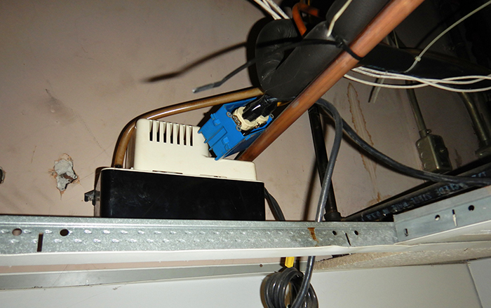

I found this condensate pump along with numerous Code violations stuffed above the suspended ceiling of a local business. The blue plastic box dangling with absolutely no support fails to comply with any of the support requirements in Sec. 314.23(A) through (H). The missing faceplate on the receptacle violates the requirements in Sec. 406.6 and Sec. 314.25. While neither the receptacle nor the condensate pump is prohibited from being installed above a suspended ceiling, the power supply cord used to connect the pump to the receptacle is a violation of Sec. 400.12. More specifically, Sec. 400.12(5) does not permit flexible cords, flexible cables, cord sets, or power supply cords to be installed where located above a suspended or dropped ceiling. Other “hard-wired” options in Chapter 3 are available for wiring condensate pumps located above a suspended ceiling. The NM cable used to provide branch-circuit power to the receptacle does not comply with Sec. 334.12. Specifically, Sec. 334.12(A)(2) prohibits the installation of exposed NM cable within the ceiling cavity of a dropped or suspended ceiling in other than dwelling occupancies. The NM cables originally may have been permitted to be installed in this location, but they have not been permitted here for several Code cycles. In addition, the lack of any securing or supporting means for the NM cable is a violation of Sec. 334.30.
