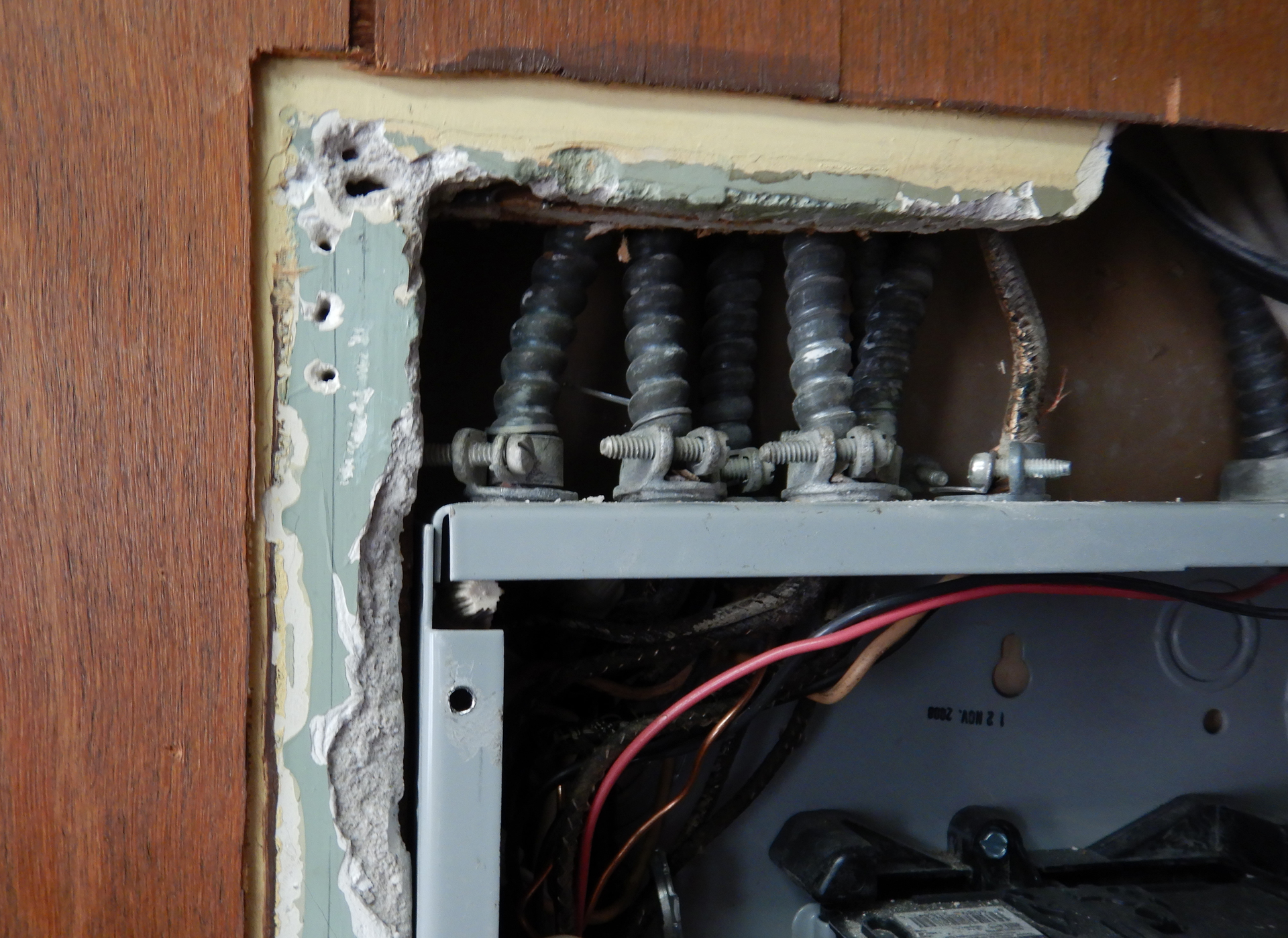

This wall is constructed of three different layers, including gypsum board, plaster, and wood paneling. The person who installed this panelboard enclosure hacked through all those layers and made no attempt at repairing the wall to maintain its fire-resistant ratings. Section 312.4 requires cabinets installed in noncombustible surfaces to be repaired so there will be no gaps or open spaces greater than 1/8 in. at the edge of the cabinet used with a flush-type cover. The gaps here are at least 3 in. or wider. Flames and smoke can easily spread through these gaping openings. In order to minimize the possible spread of fire, smoke, and other products of combustion, Sec. 300.21 requires openings around electrical equipment — such as raceways, cables, boxes, and cabinets that penetrate into or through fire-resistant-rated walls, partitions, floors, or ceilings — to be firestopped with approved methods to maintain the fire-resistance rating of the assembly. Even small openings can allow fire and smoke to spread from one part of a building to another part. It is imperative for these openings to be repaired or otherwise closed to minimize this spread.
