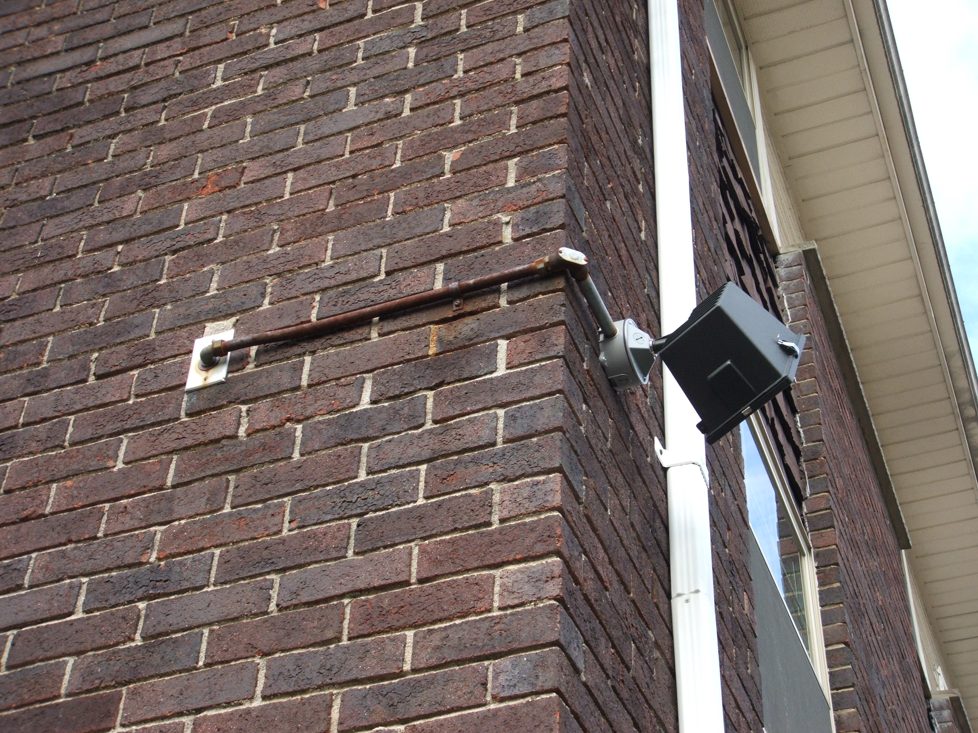

Access Denied
Gaining access to the wiring in the recessed box on the left side of this raceway run will be a real chore because a flexible raceway was not used. That rusted electrical metallic tubing (EMT) raceway will need to be disassembled to remove the cover. When I first spotted this installation, I thought the EMT was a liquid-tight flexible metal conduit (LFMC). Upon closer inspection, I realized it was EMT. Making surface extensions from a cover is permitted by the Code, but this installer did not do it correctly. Section 314.22 requires surface extensions to be made by securing an extension ring over the box, but the exception permits surface extensions to be made from the cover of a box — if the cover is unlikely to fall off or be removed assuming its means of securement becomes loose. It also requires flexible wiring methods to be used when making an extension from a cover. The length of the flexible wiring method must be such that it permits the removal of the cover and provides access to the interior of the box. Grounding and bonding continuity must be independent of the connection between the cover and the box.

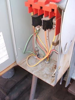

Lord of the Knockout Rings
Stuffing several equipment grounding conductors (EGCs) into a lug designed for only one conductor is the first problem I want to point out here. Section 110.14(A) requires terminals for more than one conductor to be identified for that use. The next problem here is the lack of bonding bushings installed on the connectors for the metal raceways where they enter this metal enclosure. We don’t want fault current traveling through those knockout rings on circuits above 250V to ground. Where oversized concentric or eccentric knockouts are encountered when installing circuits of over 250V to ground, Sec. 250.97 requires electrical continuity between the metal raceway and metal enclosure to be ensured by bonding and grounding methods specified for services in Sec. 250.92(B)(2), (3) or (4). Bonding bushings with bonding jumpers should be used for bonding these raceways containing 480V circuit conductors. If no knockout rings were encountered — or if the enclosure was listed for reliable bonding above 250V to ground — then following the bonding techniques specified in Sec. 250.92(B) would not be required. In this case, typical threadless connectors could be used or cable connectors with one locknut inside the cabinet (as was done, albeit incorrectly here), or other listed fittings could be used.
