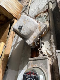

Corrosion of Conformity
This photo shows us an excellent example of why Sec. 300.6 exists in the Code. That Section requires, among other items, raceways, cable armor, boxes, fittings, supports, support hardware, cabinets, boxes, and other enclosures to be made of materials suitable for the environment where they are installed. For ferrous metal equipment, Sec. 300.6(A) requires these items to be protected against corrosion on the inside and outside by an approved corrosion-resistant coating. Whatever coating was used on this equipment did not seem to fare very well. Rust has eaten away the bottom of the disconnecting means to the point where the raceway has completely separated from the enclosure,  leaving the conductors exposed to being damaged from the jagged edges of the rusty metal enclosure. Rain and moisture can now easily enter the meter socket enclosure, increasing the risk of shock and fire. The rays of the sun can also wreak havoc with the exposed conductor insulation too. The lack of electrical continuity and mechanical connection between the raceway and enclosure now violates Sec. 300.10 requirements along with many bonding and grounding requirements in Art. 250. I don’t think either of these enclosures comply with the requirements in Sec. 312.2 anymore.
