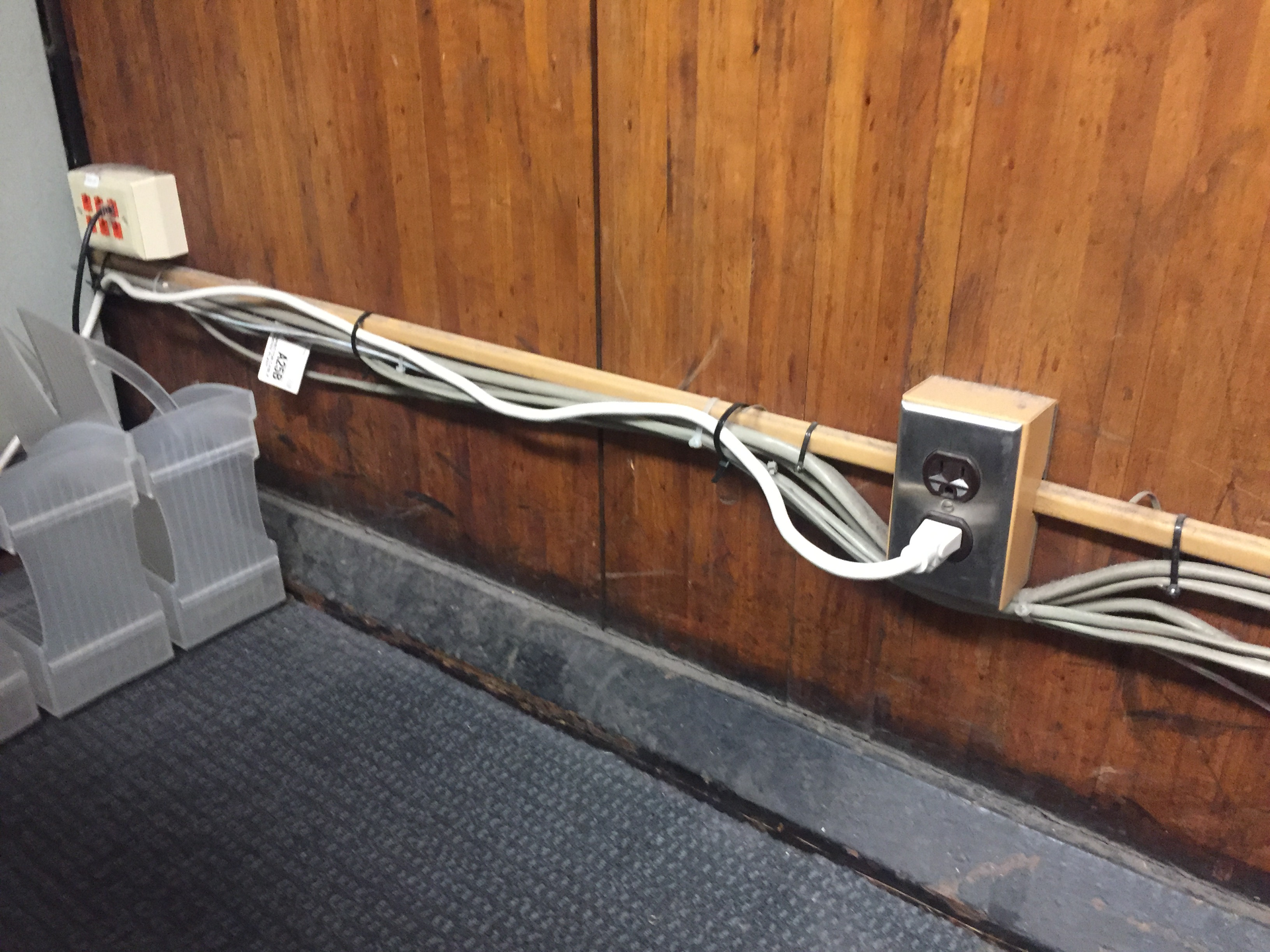

Cable Cluster
While this installation appears to have been installed prior to the existence of the 2023 Code, it still provides us with an opportunity to show some examples of Code violations based on the newest edition of the Code. New Art. 722 provides requirements for cables installed for Class 2 and Class 3 power-limited circuits and Class 4 fault-managed power circuits. Section 722.24(B) informs us that these cables cannot be strapped or attached by any means to the exterior of any raceway, including the surface metal raceway shown in this photo. Neither of the exceptions for this rule is applicable to this installation. For communication circuits, Sec. 800.133(C) also prohibits cables from being attached by any means to the exterior of any raceway as a means of support. The exception for this rule is not applicable here. Securing the power supply cord to the exterior of the raceway is also a violation. Section 300.11(C)(1) allows cables, raceways, or other nonelectrical equipment to be supported by raceways, but only where the raceway or means of support is identified as a means of support. A surface metal raceway is not identified for this purpose.
