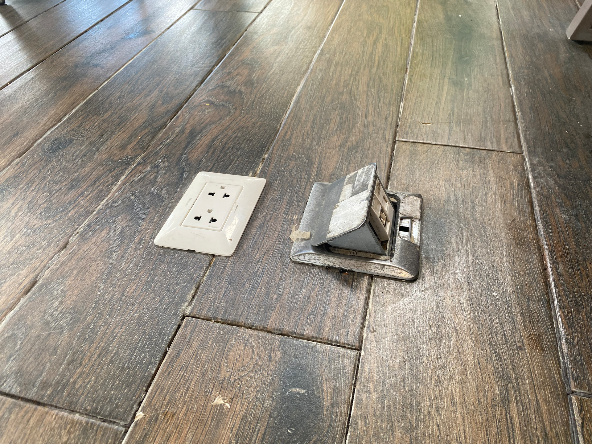

I spotted these interesting outlets on the floor of an outside seating area for a restaurant. In seating areas, Sec. 406.5(H) prohibits receptacles from being installed in a face-up position unless installed in either a listed floor box, an assembly listed for countertop applications, an assembly listed for commercial or household furnishings, or an assembly listed as a furniture power distribution unit. Section 314.27(B) requires listed floor boxes to be used for receptacles installed in floors. This receptacle appears to be mistakenly installed in a general-purpose device box rather than a listed floor box. Section 406.9(B) requires the use of weather-resistant (WR) type receptacles in damp locations such as this. For 2023, Sec. 406.4(G) requires physical protection for floor receptacles to allow floor-cleaning equipment to be used without damaging the receptacle. Running a floor-cleaning machine over this receptacle could cause serious damage to the receptacle. Additionally, Sec. 210.8(B)(6) requires GFCI protection for these receptacles. This incorrectly installed, face-up floor receptacle certainly poses an increased risk of shock and fire. At least the installer took more care when installing the tel/data outlet. That pop-up enclosure seems more appropriate for installations in floors.
