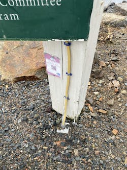

Wrong Wiring Method for Outdoors
I noticed the wiring on this sign while visiting a local seafood restaurant. The bright yellow cable grabbed my attention as I walked from my car through the oceanside parking lot. When I took a closer look at the cable, my suspicion that it might be an NM cable was confirmed.
Type NM cables cannot be installed outdoors. Section 334.12(B)(4) clearly states that Type NM cable is not permitted to be installed in damp or wet locations. This is certainly a wet location. There is also a gray UF cable installed behind the yellow NM cable. UF cable is permitted in this outdoor wet location; however, some protection from physical damage should have been provided, since this cable could be stepped on, kicked, bumped, or otherwise damaged. Jamming two cables into a connector designed for only one cable is a violation of Sec. 110.3(B). I’m not sure if those blue insulated NM cable staples are suitable for installation in direct sunlight or this outdoor wet location. Lastly, the buried PVC junction box is probably fine for installation in wet locations, but I am not sure if it is identified or listed for being directly buried in the ground.
