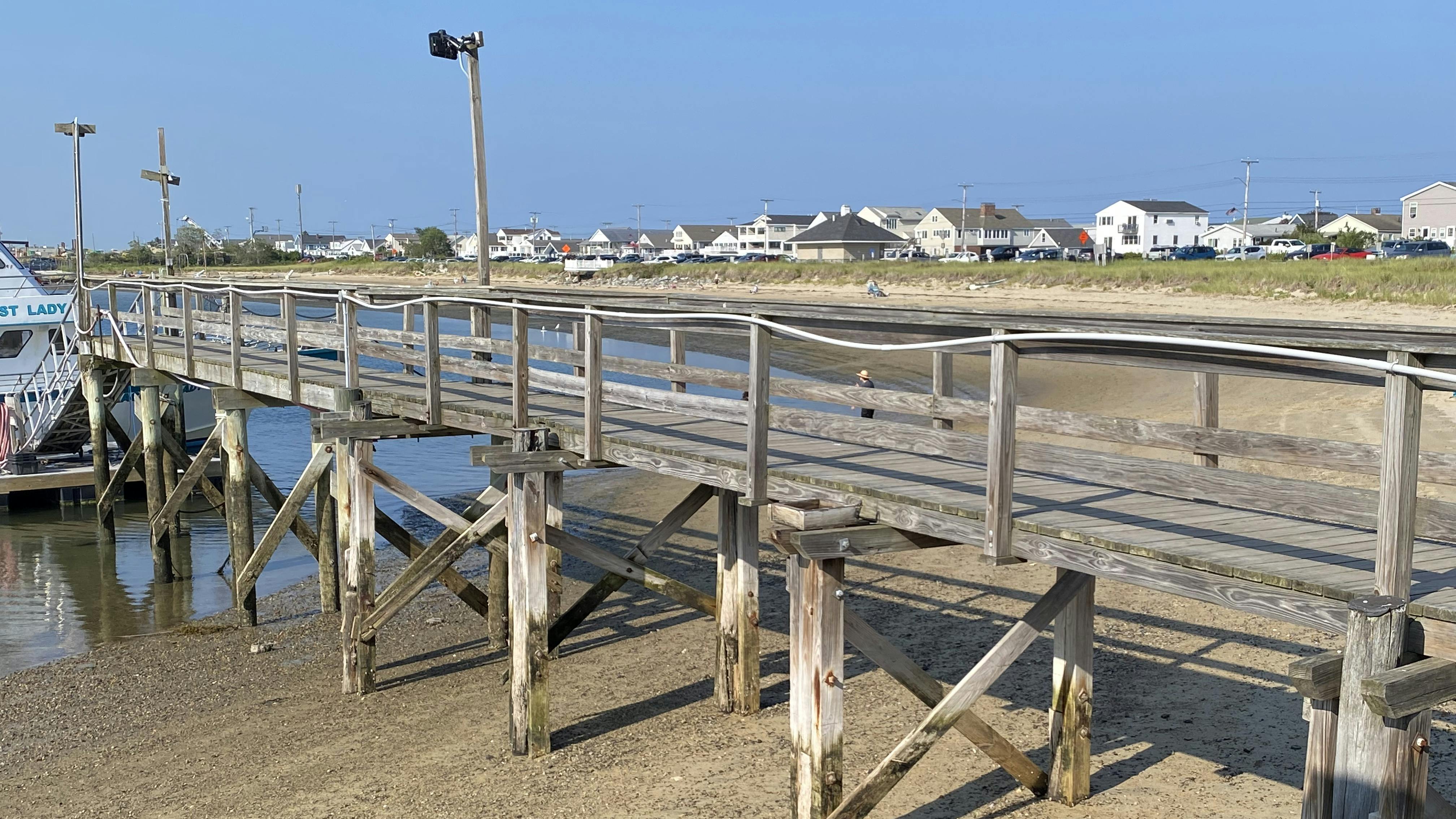

Waves in rigid PVC conduit are not the kind of waves you expect to see at the beach, but the lack of expansion fittings and too few conduit clips have caused this conduit run to become a wavy mess. Table 352.30(B) requires the maximum spacing between supports for rigid PVC conduit to be limited to 3 ft for conduits of trade sizes 1/2-in. through 1-in. The clips used to support this conduit run are spaced way too far apart. That one violation by itself can cause the conduit to droop and sag. Now, add the lack of an expansion fitting as required by
Sec. 352.44(A), and the sagging and drooping problem increases dramatically.
Long, straight PVC conduit runs like this one can experience surprisingly large changes in length due to thermal expansion and contraction. For example, according to Table 352.44(A), a 100-ft run of PVC conduit could experience a length change of approximately 4 in. as the seasons change from a cold winter day to a hot summer day and back again. That is an amazing change in length and could potentially cause the conduit run to self destruct if expansion fittings are not used to accommodate that length change.
