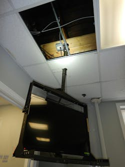

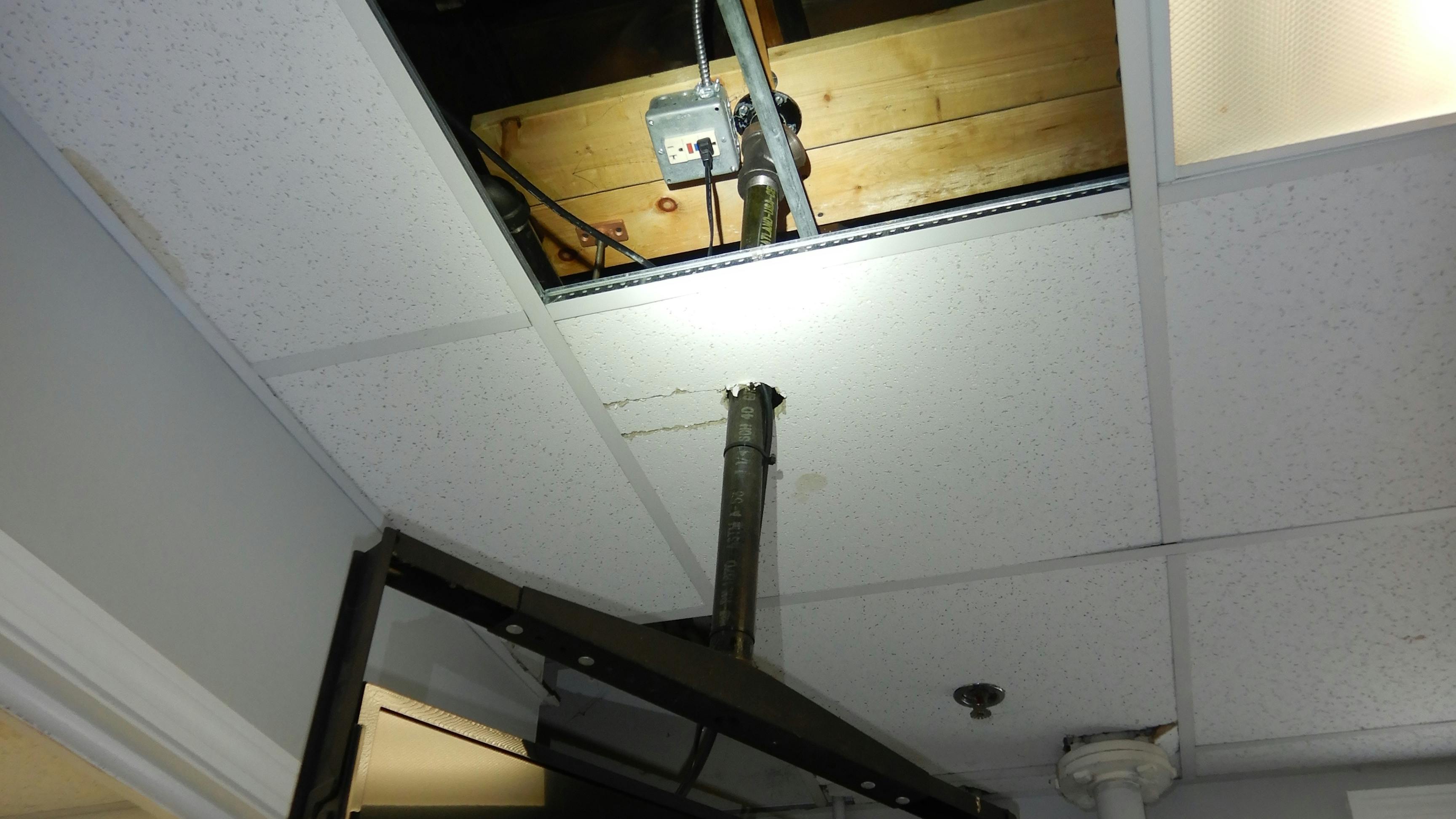

While there are no rules prohibiting the installation of receptacle outlets above suspended ceilings, there are rules restricting what equipment can be plugged into those receptacles. For permanent installations, such as the TV/display monitor shown in this photo, Sec. 400.12(5) prohibits the power supply cord of the display monitor from being located above the suspended ceiling.
For using portable tools, such as portable drop lights and vacuums (and other portable equipment not part of a permanent installation), temporarily plugging in the power supply while using the portable equipment is not the issue. The problem arises when installers plug in permanently installed equipment. Another example of this violation that I frequently encounter is the placement of condensate pumps for air handlers above the suspended ceiling. The power supply cords for these permanently installed condensate pumps are also prohibited from being located above the suspended ceiling per Sec. 400.12(5). Installing a receptacle outlet below the suspended ceiling and plugging the display monitor into that receptacle would be one way to correct the installation shown.
