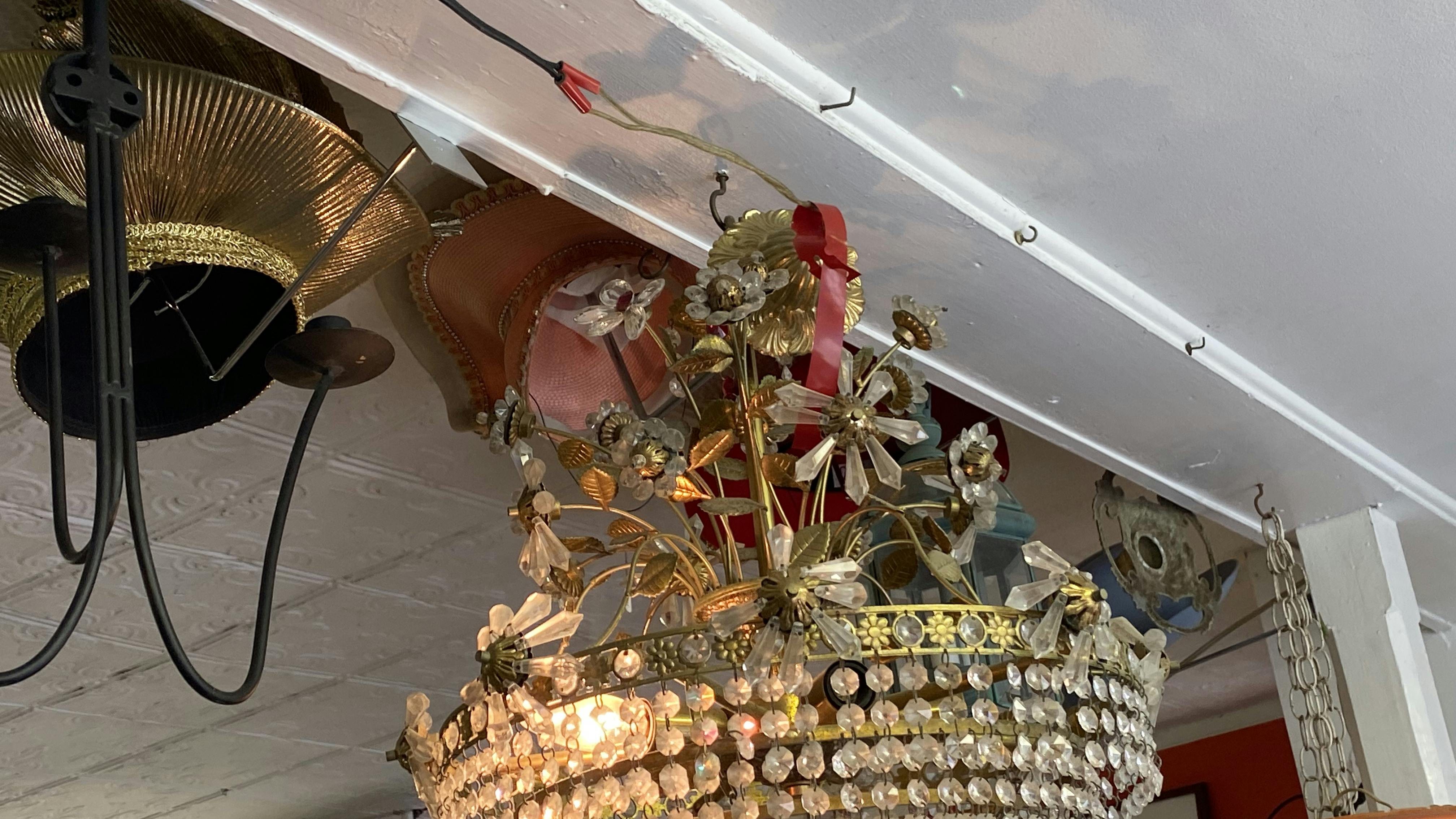

I discovered this fancy chandelier for sale in a local shop. I also noticed some questionable wiring for this luminaire. The lamp cord feeding it has been spliced with two red crimp connectors and extended over to a receptacle where it is plugged in. Splicing and extending the lamp cord is a violation of Sec. 400.13. Are the metal parts of this luminaire connected to an equipment grounding conductor (EGC) in accordance with Part V of Art. 410? I don’t think so. The lamp cord only has two conductors. There is no EGC to trip the circuit breaker in the event of a ground fault in the luminaire wiring.
Perhaps the shop owner did this handy work or hired an unqualified person to power up this luminaire for display purposes. I’m not sure of that, but I am sure that this luminaire is presently not grounded and bonded. I am also wondering if this chandelier is listed as required by Sec. 410.6 (Sec. 410.2 in the 2026 edition). Over the years, I have had several customers purchase unlisted or custom-made luminaires at flea markets, yard sales, and garage sales, only to have me inform them that I would not install them because they were not listed.
