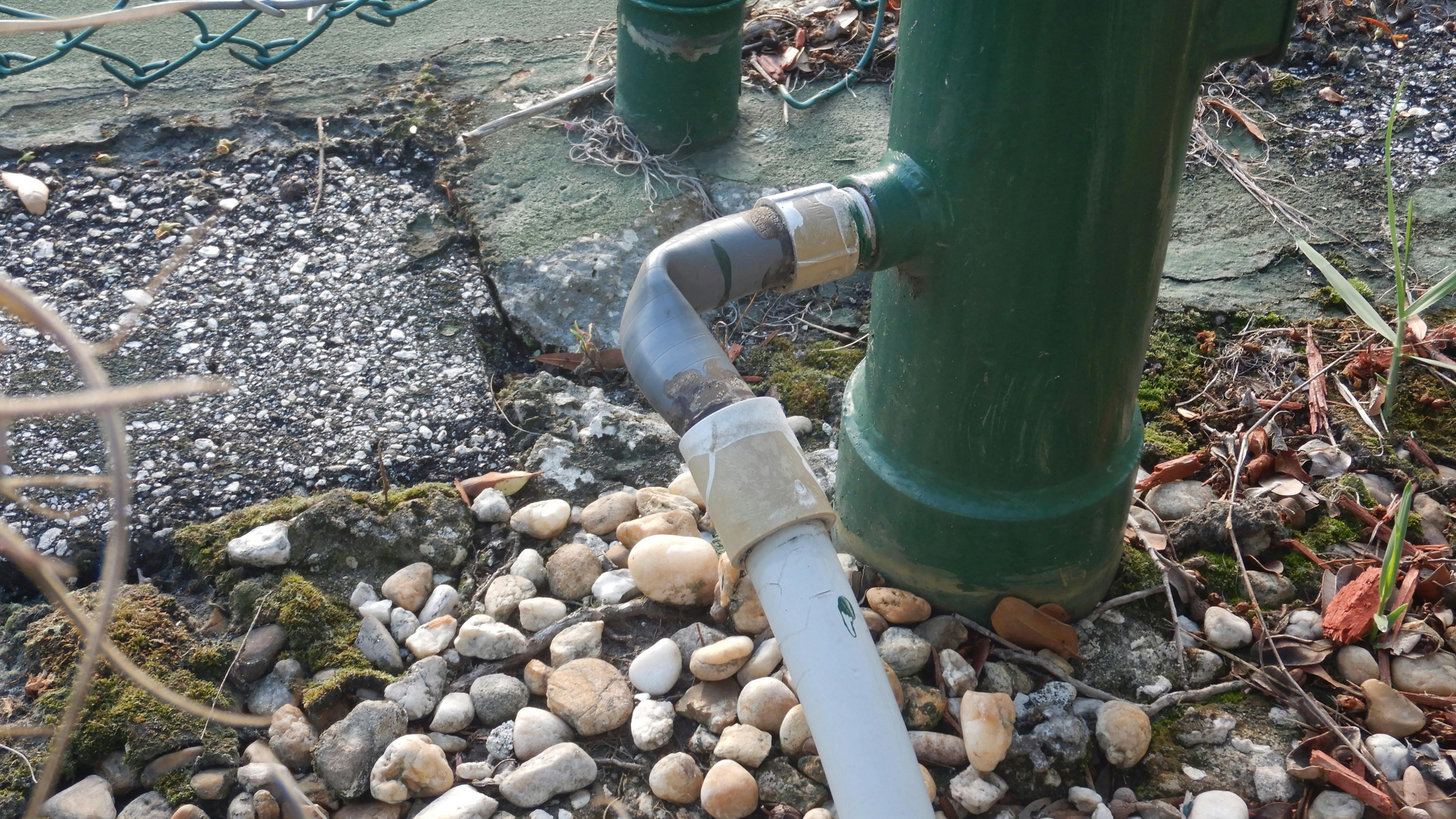

Sharp Turn Ahead!
I’m guessing this installer did not have an LB, a box, a 90-degree rigid PVC conduit fitting, or a rigid PVC conduit bender. So, instead of using the correct fittings or bending methods to make this turn, he simply glued a piece of liquidtight flexible nonmetallic conduit (LFNC) into the rigid PVC conduit coupling and connector.
The second paragraph of Sec. 300.17 (Sec. 300.15 in 2023 edition) requires fittings and connectors to be “used only with wiring methods for which they are designed and listed.” Similarly, Sec. 356.42 requires only fittings listed for use with LFNC to be used with LFNC. Rigid PVC conduit connectors and couplings are not listed for use with LFNC. Using fittings with wiring methods for which they are not listed is also a violation of Sec. 110.3(B). The ultra-sharp bend in the LFNC certainly does not comply with the bending requirements in Sec. 356.24. A sharp bend like that will make it virtually impossible to pull conductors through that raceway! Lastly, I would say that this insulation was not done in a professional and skillful manner and does not comply with Sec. 110.12.
