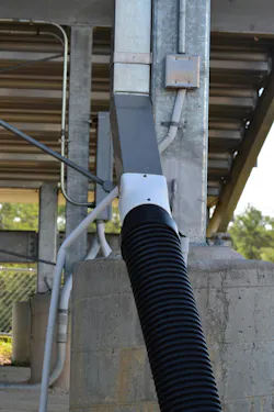

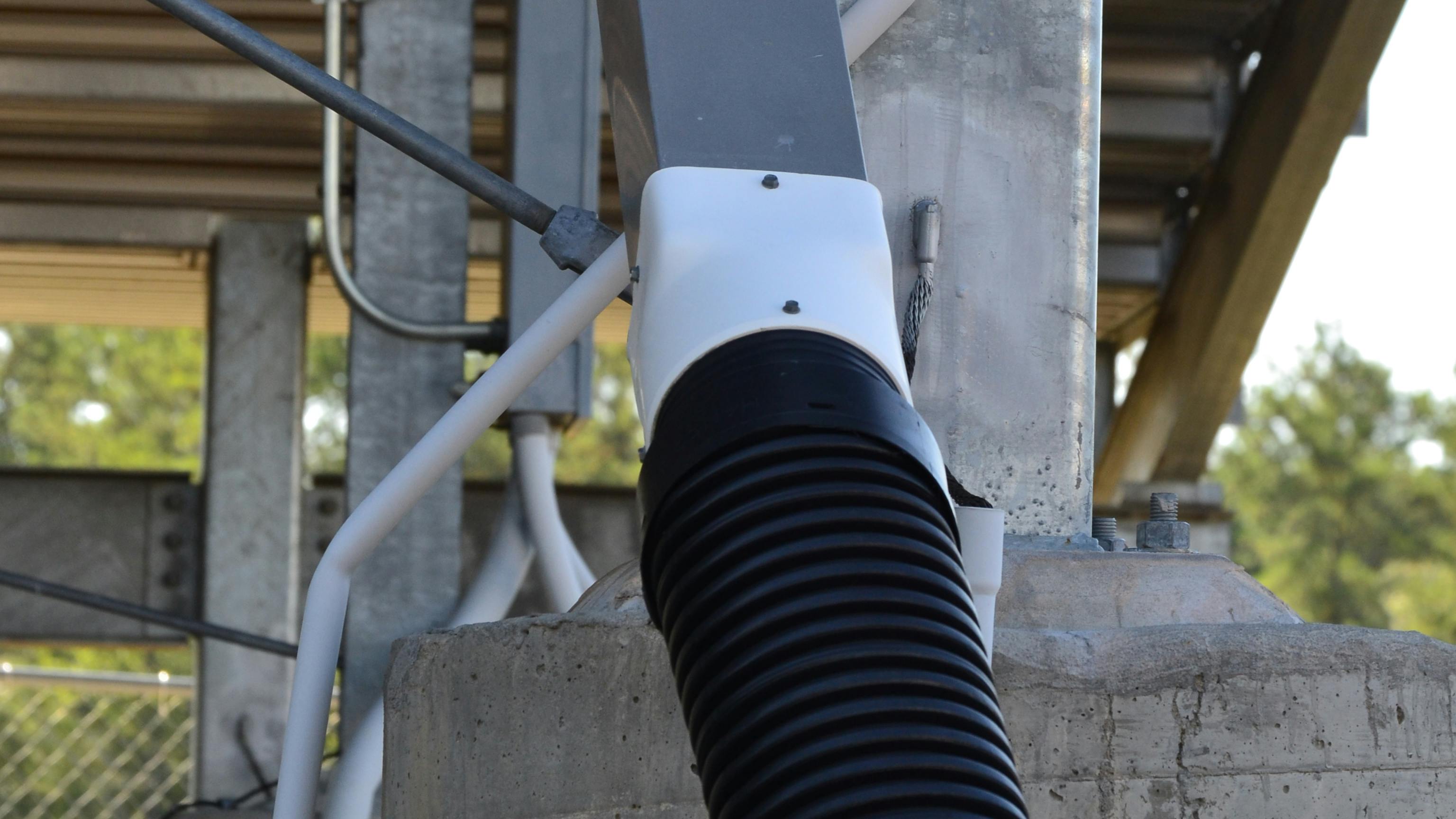

Deep Knee Bends?
Apparently, the person who installed the rigid PVC conduit into the bottom of the weatherproof box didn’t have access to bending equipment or any factory-made bends. Instead, it looks as though he or she bent the conduit over their knee. The result was a conduit that is kinked in a few spots.
Making bends as horrible as what’s shown here is a violation of Sec. 352.24(A). Bends are supposed to be made so that the conduit is not damaged and so there will effectively be no reduction of the internal diameter of the conduit. Bends made in the field must be made with bending equipment identified for the purpose.
After a closer look, you may also spot another problem. The rigid PVC conduit is not connected to the box. There is no connector on the conduit. It is just shoved up tight against the threaded opening in the box. I would consider this a violation of Sec. 300.14 [Sec. 300.12 in 2023] because the raceway is not continuous or mechanically secured to the box. One last problem to point out is the lack of an expansion fitting on the PVC conduit emerging from grade. I would consider this a violation of Sec. 300.7(J) [Sec. 300.5(J) in 2023].
