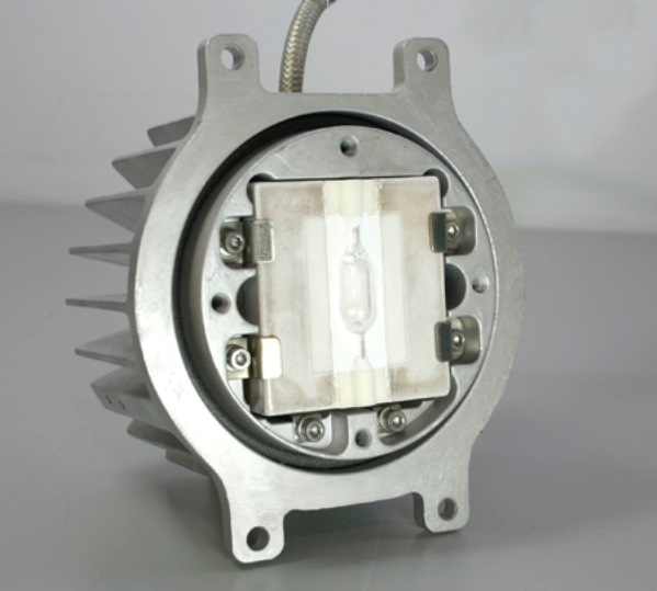

The Lighting Research Center has released the Lighting Answers: Plasma Lighting Systems report. This National Lighting Product Information Program report helps lighting specifiers to understand plasma lighting systems and their performance characteristics, including light output, system efficacy, color characteristics, lumen maintenance, and rated life. This report also provides information about operating orientation, dimming, warm-up, and restrike times, electromagnetic interference and compatibility (EMI/EMC), and ultraviolet (UV) radiation.
