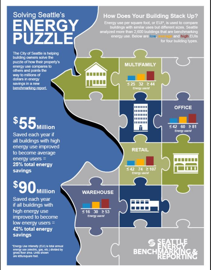

To help Seattle owners see how their building’s energy use stacks up to their peers, the analysis established performance ranges for 13 different building types based on their reported 2012 energy use. For example:
  • An office building reporting an energy use intensity (EUI or energy use per square foot annually) of 60 kbtu/sf is about average for Seattle.
  • Multifamily (apartment and condo) buildings, which tend to use less energy than offices, had an average EUI of about 32 kbtu/sf.
Seattle buildings have high energy and money savings potential
  • If all the highest energy users improved to the average level of efficiency for their building type, owners would save a combined $55 million on utility bills each year and lower annual energy use by an average of 25% across all buildings.
  • If these same buildings improved to match the energy efficiency levels of the best performing buildings in their class, utility bill savings would surpass $90 million each year and annual energy use would decline by an average of 42%.
