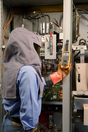

  3. Quick measurement checks
    Measure VFD input voltage with a true-rms digital multimeter, verifying voltage unbalance falls within manufacturer's specifications. Measure harmonic frequencies and levels at the point where power is supplied into the VFD, using a power quality clamp meter or power quality analyzer. In addition, check for harmonics back at the feeder where the power to the VFD is also supplying other loads.
    If voltage unbalance is the problem, shift and evenly distribute single-phase loads. If harmonics are found to be the cause, contact the drive manufacturer or a harmonic filter manufacturer, and install a properly tuned harmonic filter.
