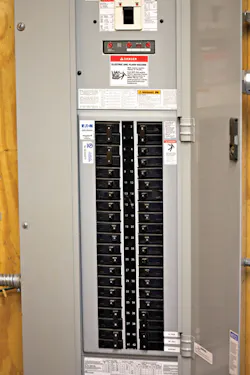

Fuses provide perfectly competent overcurrent protection. However, in residential and other low-power applications, they are considered obsolete, though still Code-compliant. Besides being resettable, a circuit breaker provides a clear visible indicator when it has switched off after detecting a fault. In addition, these types of panelboards are easier to wire and repair.

Breakers should be exercised (turned off and on) periodically. Trade practice is for breakers to be exercised once per year, regardless of size. Where there is no excessive dust or humidity, this interval may be extended to once every three years, but the procedure is so easy that you might as well do it once a year. This is particularly true in the larger sizes, and it should be part of the preventive maintenance program in any large facility. If properly maintained, breakers last a long time. However, some workers intentionally shunt a branch circuit in order to trip the breaker. This is a very poor maintenance practice, because it stresses the contacts and shortens the life of the breaker.
