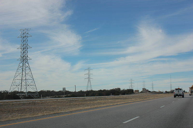

A report recently released by the Electric Reliability Council of Texas (ERCOT) identifies several transmission improvements planned for the next five years to address growing needs on the electric grid that serves most of Texas.
According to the 2013 Report on Existing and Potential Electric Constraints and Needs, transmission providers in the ERCOT region expect to complete more than $3.6 billion in projects between 2014 and 2018. These include additions or upgrades to more than 3,300 miles of transmission lines and other equipment improvements to increase capacity and support reliability.
Improvements identified in the report focus on existing and potential constraints, where limited capacity of transmission infrastructure could create reliability concerns or increase power costs for consumers in the next five years.
