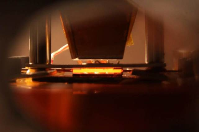

Optical image of the vacuum-enclosed device illustrating the energy conversion processes in a nanophotonic solar thermophotovoltaic device: Sunlight is converted to useful thermal emission, and ultimately electrical power, via a hot absorber-emitter (at center, glowing orange).

To address that limitation, the team inserted a two-layer absorber-emitter device — made of novel materials including carbon nanotubes and photonic crystals — between the sunlight and the PV cell. This intermediate material collects energy from a broad spectrum of sunlight, heating up in the process. When it heats up, as with a piece of iron that glows red hot, it emits light of a particular wavelength, which in this case is tuned to match the bandgap of the PV cell mounted nearby.
