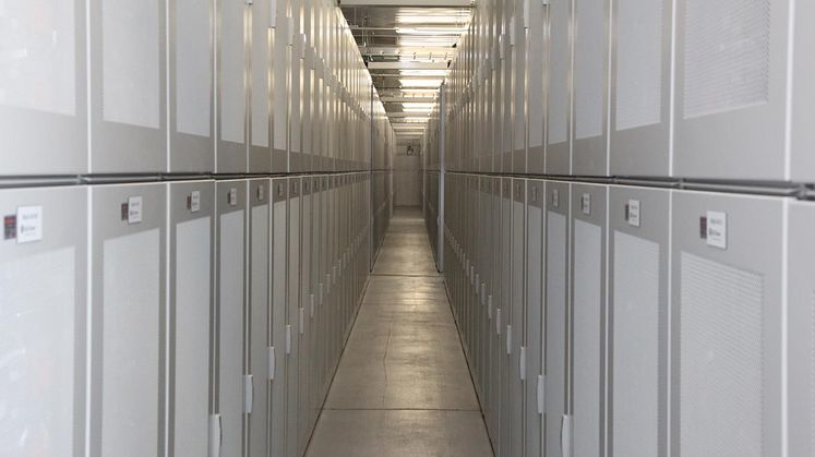

The 32 megawatt-hours battery energy storage system features lithium-ion batteries housed inside a 6,300 square-foot facility at SCE’s Monolith substation in Tehachapi, Calif. The project is strategically located in the Tehachapi Wind Resource Area that is projected to generate up to 4,500 MW of wind energy by 2016.

The battery system supplied by LG Chem is comprised of 604 battery racks, 10,872 battery modules and 608,832 individual battery cells – the same lithium-ion cells installed in battery packs for General Motors’ Chevrolet Volt.
