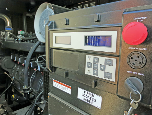

Backup generation systems vary depending on customer needs. Facilities for large computer-based companies, such as Amazon, telecommunications companies, and data centers want to see total redundancy — a complete generator backup all the way down to the server on the raised floor — so it will never experience an outage.
“All new servers nowadays have dual power sources or dual cords: an A + B or C + D or AB and CD sides,” McCulloch says. “Regardless of what side it is, every server has to have two sources: an A and a B power source, so if one server loses a power supply, the other power supply will keep it stabilized. You want to have it set up so power is from different distribution units all the way to the server.”
Keep in mind that there are also different tiers of backup. With what is called N power, a 2MW load would have 2MW of backup generation. That might sound sufficient, but if the backup generators fail, this would not be acceptable in many situations. N+1 would be the minimum backup configuration in a critical data center environment. With N+1, for a load of 2MW, there would be an infrastructure in place to provide 3MW. With 2N, there would be an infrastructure for 4MW, doubling the infrastructure for the load. “With N+1 or 2N, everything is redundant,” McCulloch says. “An A and a B side would each be loaded to 40%. If A fails, B takes control at 80%.”
Some customers may also use a UPS. Why? In hospitals and data centers, a UPS is used to carry the critical load for a short period of time where the power cannot be interrupted at all (i.e., operating rooms and critical servers in data centers). Once the generators are up and running, the UPS goes back to a normal state. Although the generators are sized to take control of most, if not all, of the facility load, the UPS is sized to only cover the critical load, which varies depending on each client’s needs.

With a stand-alone generator, when the utility source fails, an automatic transfer switch (ATS) sends a start signal to the generator to start. Once it is at rpm and reaches the rated voltage, the ATS sends another signal to indicate to transfer to the emergency source.
