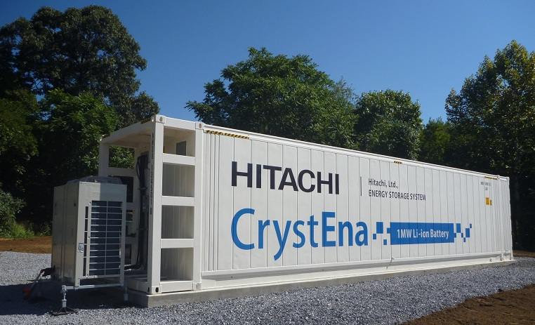

Hitachi America, Ltd. and Demansys Energy, Inc. have completed construction and commissioning of a 1MW Lithium Ion energy storage facility using Hitachi’s CrystEna compact container-type energy storage system. The demonstration project is located in Somerdale, N.J.

Hitachi supplied the energy storage system, which is the first North American deployment of its CrystEna compact container-type energy storage system and includes the lithium ion batteries, power conditioning system, battery management system, and cooling and fire suppression systems all in one 45 ft shipping container. Hitachi is using this installation to prove its product in the PJM market in the US and to collect data that will be used to further improve the offering.
