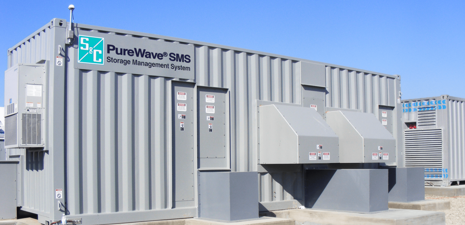

HMV will use S&C's 7MW PureWave SMS Storage Management System, providing fully integrated storage management and power conversion for 3MWh of lithium ion-batteries. The system will help Minster better manage energy demand during peak periods and provide reliable back-up power, while deferring the acquisition of costly reactive power compensation equipment. The system will also be tied to HMV's adjacent 4.2MW solar plant, allowing Minster to further reduce their peak demand charges in the middle of the day. Once complete, the solar + storage system will be the largest U.S. facility of its kind connected through a municipal utility.
