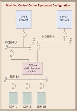

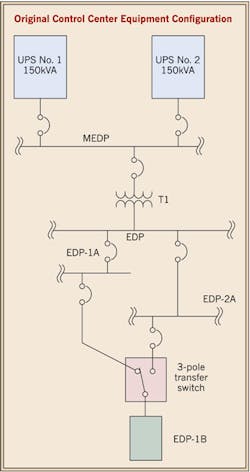

The utility’s original control center included two 150kVA/120kW UPS units (with 480VAC outputs) configured as a parallel redundant system (Fig. 1). The system was replaced by two 200kVA/200kW modular UPS systems and a 150kVA STS with a reconfigured distribution wiring system. With the new system, UPS System ‘A’ feeds ‘A’ power supplies while UPS System ‘B’ feeds ‘B’ power supplies in the dual power supply IT equipment arrangement. All single-corded equipment is powered by the STS (Fig. 2).
Fig. 2. Partial one-line diagram of the completed upgrade configuration.

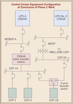

The retrofit was completed in several phases, which allowed operations to continue uninterrupted. Phase 1 included removing UPS System 1 while all existing loads were supported by UPS System 2 and installing new UPS system ‘A’ and the STS. Several existing load panels were moved to the STS, and several new panels were installed.
At the conclusion of Phase 1, UPS System ‘A’ and the STS were factory started and commissioned. But, as the contractor continued to add more new panelboards, “High Output Ground Current” alarms began occurring on the STS (Fig. 3). At this point, a service call was placed to the STS manufacturer. It recommended the ground sensing circuit be calibrated, and dispatched a technician under a warranty service call.

Fig. 3. Partial one-line diagram of system after completion of Phase 1 work.

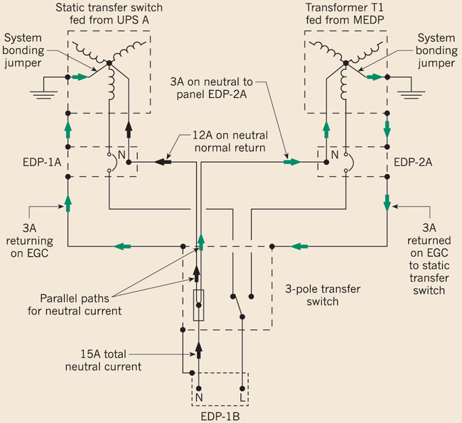

The next step was to choose a panel and begin isolating the cause of the unwanted ground current. In the original installation, EDP-1A and EDP-2A each fed one source of a transfer switch. EDP-2A was not being used after the completion of Phase 1, but would be returned to service at the completion of Phase 2 of the overall project. Since it was not supporting any critical load, it made for a convenient place to start.
While inspecting panel EDP-2A, 3A of current was measured on the neutral and ground conductors from the transfer switch. No load was being supported by panel EDP-2A; therefore, no current should have been present on any conductors.
Fig. 4. Tracking down the source of objectionable currents in a system can be a time-consuming and tedious process.
During an inspection of the transfer switch, the neutral conductor feeding Panel EDP-1B measured 15A. But the neutral returning to Panel EDP-1A only measured 12A. The current returning on the neutral of EDP-2A measured 3A. A current of 3A was measured on both the EGCs of feeds from Panel EDP-1A and EDP-2A (Fig. 4).
Panel EDP-1B was only powered from EDP-1A, so no current should have been present on any conductors in EDP-2A. The neutral conductor in panel EDP-2A was removed, which isolated all phase and neutral conductors from the transfer switch. This removed the parallel path for the neutral current in panel EDP-1B. All 15A of neutral current was now being carried by the neutral of panel EDP-1A, eliminating ground current on panel EDP-1A and EDP-2A. This reduced the total ground current on the STS from 10A to 7A.
Before the installation of the parallel 150kVA UPS systems, the existing installation used a 3-pole transfer switch to feed panel EDP-1B, which supported telephone operations. This provided redundant power sources for the telephone system. Source one of the transfer switch was from EDP-1A and source 2 from EDP-2A. Both panel EDP-1A and EDP-2A were fed from the parallel UPS systems output wiring arrangement during a previous upgrade (Fig. 1 on page 14).
Panels EDP-1A and EDP-2A were existing panels, and their neutrals were bonded to the neutral lugs in the transfer switch. With the re-feed of panel EDP-1A from the new STS, the parallel paths were from different sources. For current to return to the source of EDP-1A, current on the neutral conductor of EDP-2A could only return on the equipment ground conductor (see Fig. 4 for details).
It should be noted that the ground current measured on panel EDP-1A and EDP-2A was the same current. Finding and correcting the parallel paths in the transfer switch eliminated the ground current in panel EDP-1A and reduced the ground current on the STS to 7A.
The re-use of the existing 3-pole transfer switch was incorrect for the system configuration. It allowed parallel paths for neutral current to be shared by both EDP-1A and EDP-2A. There was no ground current monitoring on the original system to identify this issue. In addition, the neutrals returned to the same source (transformer T1), which reduced the likelihood of ground current during normal operation.
It was recommended the STS be removed from service as the new infrastructure already provided redundant sources of UPS power to panel EDP-1B. An alternate option would have been to install a 4-pole transfer switch to prevent parallel paths for current on the neutral wire and comply with the NEC. The owner decided the transfer switch was not needed, and removed it from service.
