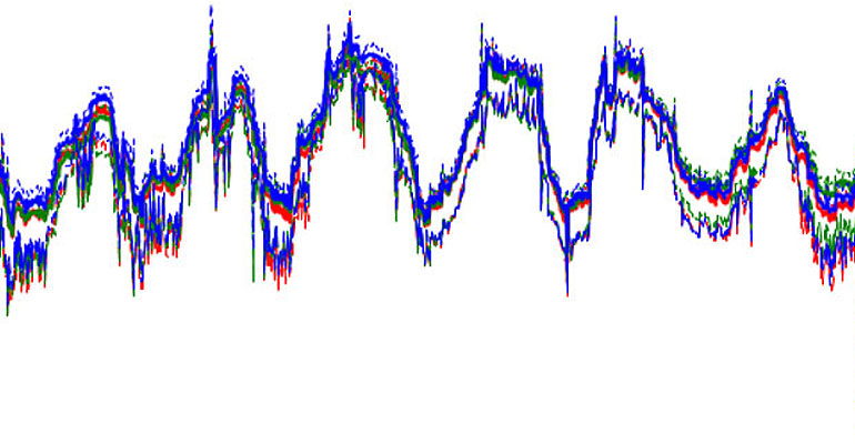

Figure 1(a) illustrates a voltage trend in a heavy industrial plant where LED driver failures occurred. You can see there is noticeable separation between the average RMS voltage from phase to phase. There are also noticeable steps in the phase-to-neutral voltages with one major step occurring on Saturday, April 25. Prior to this date, the voltages were running a little low, but still within industry limits. You can also see that after the major step, there were significant excursions in the phase-to-neutral voltage over the next several days. There was also a voltage sag on April 24. The other interest point here is that after reviewing recorded disturbances, many of these characteristics actually represent voltage transient events with high dV/dt. (High dV/dt values indicate the line voltage changed quickly with respect to time. The change in volts can only be 50 to a few hundred volts, but the change in time can be in the one microsecond (1 × 10-6 second, or 1 µsec) range. Values of dV/dt may be high enough to damage driver electronics but not have a high enough voltage to cause a metal-oxide varistor (MOV), external or internal to a driver, to clamp. Take a look at the date/time event markers. There are four groups of power quality disturbance sets. The first set (occurring on April 22 at 18:58:32) involves mutliple events as well as the second and third sets. The fourth disturbance seems to be a single event.
Figure 1(b) illustrates a voltage trend in a commercial facility where LED driver failures also occurred. Here, there seems to be about a 24-hour cyclic pattern to the phase-to-neutral voltage. The average voltage appears to be around 283V and is still within industry limits. However, there were four voltage sags that occurred at different times. The first one seems to be dominant on Phase B while the others seem to be dominant on Phase A. All of the sags occur at a different time each day. You can also see that there were multiple sets of power quality disturbance events here. Many who set a power quality monitor do not activate the right recording functions and fail to record critical disturbance data that helps to explain why LED drivers fail. Many simply look at a voltage trend like the ones presented in this article and determine that there are no power quality problems at a lighting panel or on a lighting branch circuit. However, many of these disturbances, in fact, were also recorded as voltage transients with high dV/dt values.
Figure 1(c) illustrates a voltage trend for a commercial outdoor LED street lighting application where LED driver failures occurred. At this location, the voltage has lots of transient activity characteristics. Transient activity always seems to occur in the morning hour when the lights turn off and in the evening hour when the lights turn on. The other times where disturbances were indicated by a time stamp in between “turn off” and “turn on” are when voltage transients occur upstream of the 120V circuit derived from utility distribution power also serving residences in the area. Reviewing properly recorded disturbances along with voltage trends helps explain why the LED failures occurred.
Figure 1(d) illustrates a voltage trend in a commercial facility where LED drivers also failed. At this location, there is no distinct pattern to the dates/times in between the 24-hour cycles when the line voltage produced a maxima and minima. However, there seems to be more transients at the voltage maxima and minima, especially for the four maxima in the center of the trend. This indicates the turning on and turning off of a heavy load, which produced voltage transients with high dV/dt values.
Notice that in the above four figures of a one-week voltage trend, the power quality at each monitoring point at these four voltage levels was significantly
different. However, it is difficult to identify enough information about the quality of the line voltages and currents by only conducting a one-week monitoring period. Monitoring periods here were at least one month.
