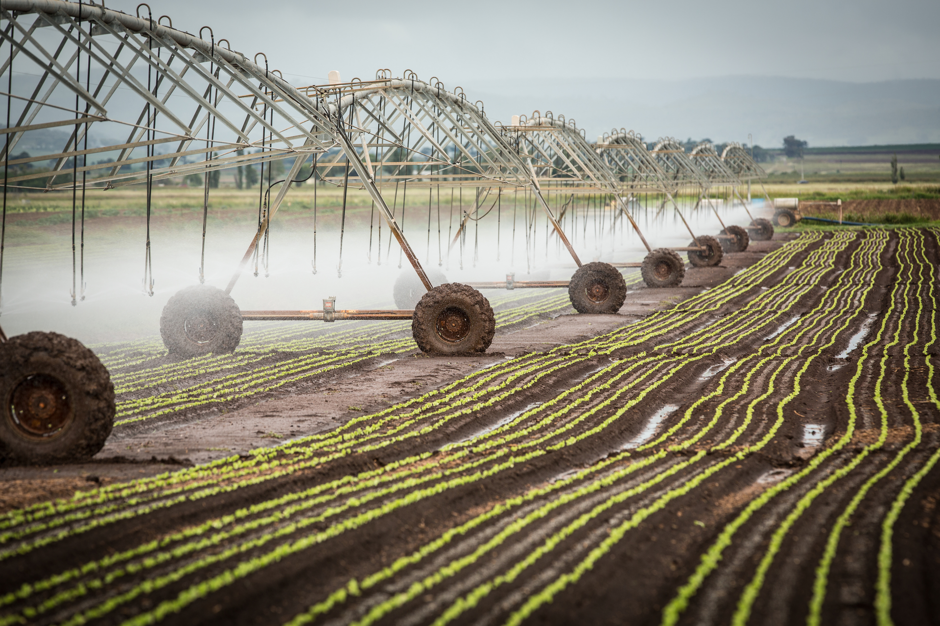

A farmer is watering an alfalfa field 24 hours a day using a 3-phase 100-hp electric motor and adjustable speed drive (ASD). The farmer checks on his field to find the water not flowing and the pump stopped. Further investigation reveals that the ASD tripped on “VUmb” or voltage unbalance. The ASD is reset and runs another 12 hours before shutting down again on “VUmb.” By the time the electrician is able to troubleshoot the problem, the motor is running again. What is voltage unbalance and why does the ASD shutdown? Let’s look into the theory and calculations to check the actual voltage unbalance.
