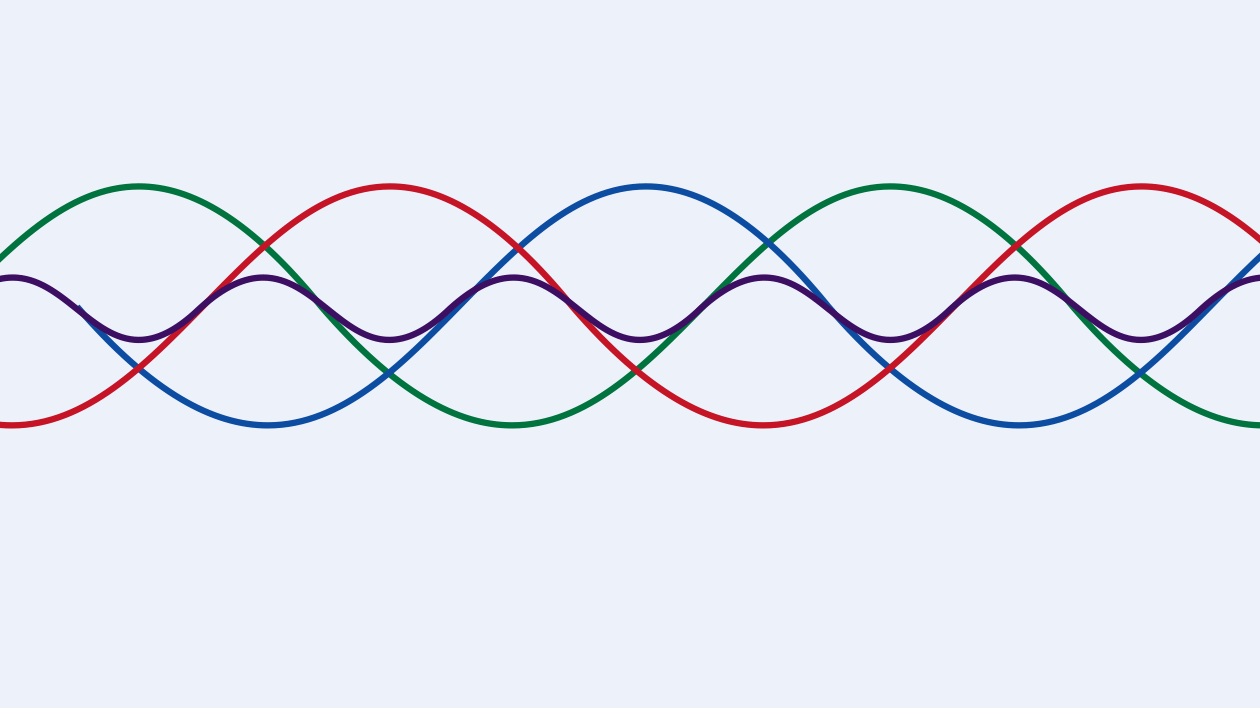

Power is supplied by a 3-phase system, where each phase is 120° apart. This is done for two reasons. First, it is because motors and/or generators that use 3-phase power are more efficient due to the constant torque the phases supply. Second, it is because after power is supplied to a load, the three phases can theoretically be added onto a neutral wire and cancel each other out. This saves the electric utility from adding return wiring to the power plant.
However, if the three phases contain 3rd order harmonics, the currents will not fully add to zero (or cancel out). As you can see in Fig. 4, the 3rd harmonics between the phases add together, which creates oscillating current. This results in a sharp increase in the zero-sequence current, which increases the current in the neutral conductor. This effect can require special consideration in the design of an electric system to serve nonlinear loads. To avoid 3rd order harmonics adding together, delta connections are used, and the current is cycled around the connection instead of a wye connection. Most harmonic problems are caused by the 3rd harmonic.
