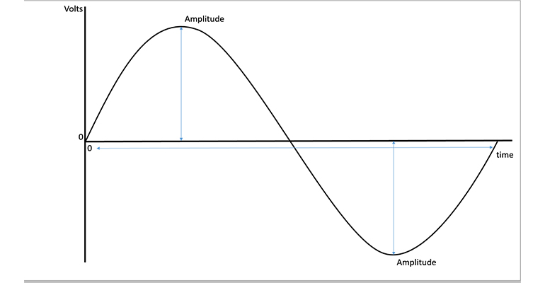

Generally, the rms value only describes the amplitude of a waveform and does not include important information, such as transient characteristics and waveform distortions. To perform a power quality investigation, it is important to review the entire voltage waveform and not just the amplitude. This requires understanding what the fundamental waveform looks like. In other words, what is the point of reference?
The fundamental voltage waveform is a sinusoidal shape that has an amplitude and time period. The period can be described as one waveform cycle. A multimeter measures the amplitude and mathematically converts it to an RMS value, by taking the waveform peak and dividing it by 1.414 or √2. In most all cases here in the United States, the electrical system operates at 60 Hz or 60 waveform cycles per second. In a 3-phase system, the individual waveforms are shifted in relationship to one another in what is commonly described as 120 electrical degrees apart. The fundamental voltage waveform is the basis for power quality studies. Power quality definitions describe any deviations from this waveform.
