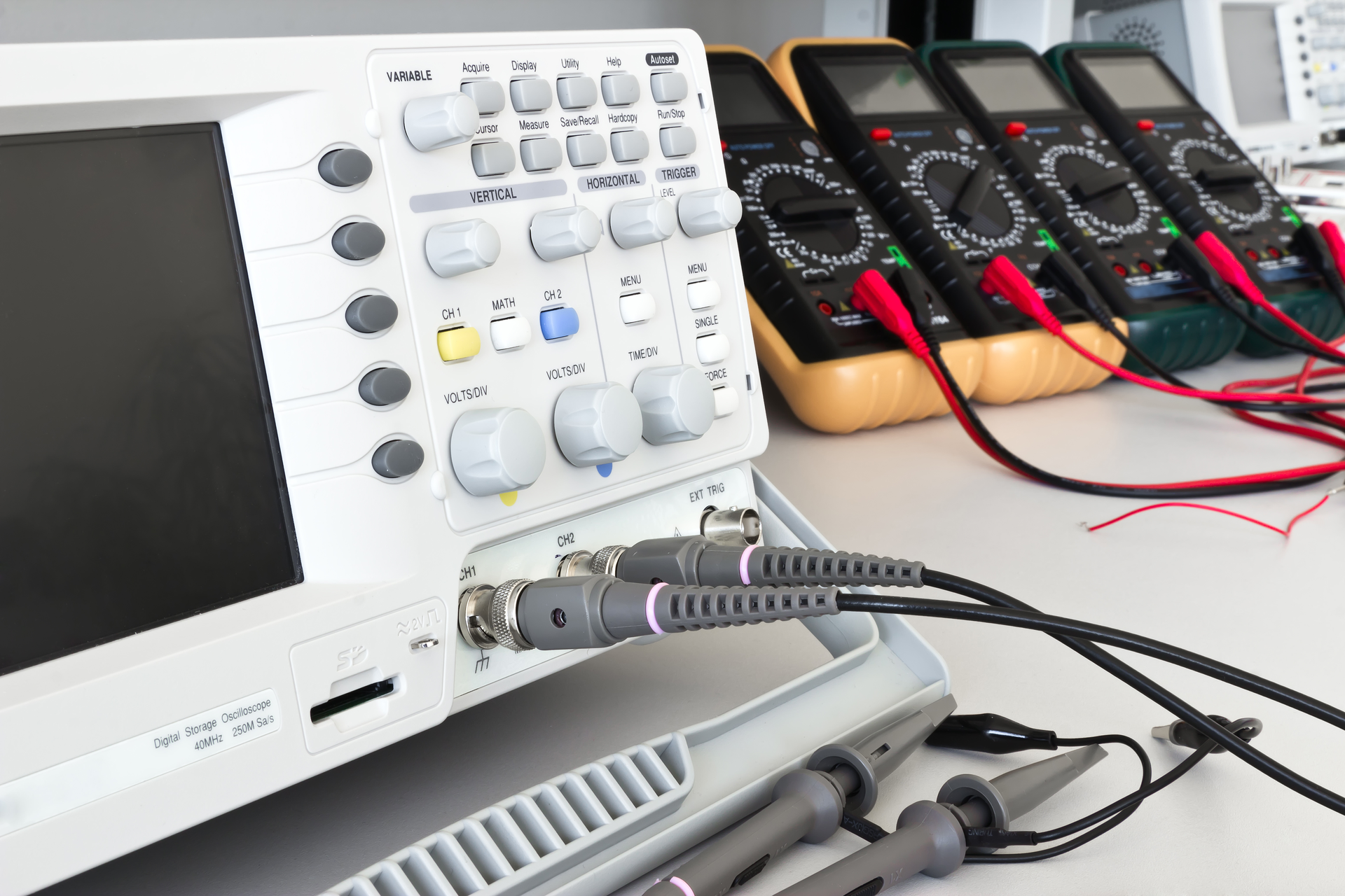

When I worked in a manufacturing facility as an electrical engineer, I can’t recall a day where I did not use an oscilloscope or a multimeter to design or troubleshoot an electrical problem. Using these two tools was second nature to me. I was rarely without my multimeter, ready to solve an electrical problem at a moment's notice. When I moved into the power quality field, I encountered a few limitations when using these two tools to investigate a power quality issue.
The multimeter captures voltage and current magnitudes, which supports detecting steady-state undervoltage or overvoltage conditions, but it does not provide information on transients or harmonics. Transient and harmonic distortion events typically cause electronic devices to misoperate when these events reach a particular level. Oscilloscopes are great at capturing periodic waveforms at a high sample rate, but imagine capturing waveforms for a week at a busy facility. The captured data can be overwhelming and analyzing it can take time, as it provides too much or too little information.
