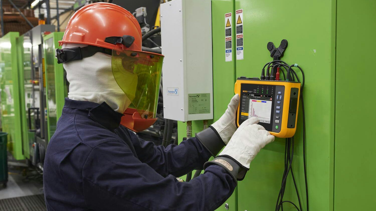

Optimizing energy efficiency in today’s industrial and commercial landscapes is more crucial than ever. One often overlooked yet vital aspect of achieving this optimization is power quality analysis, which ensures that the electricity supplied to a facility meets the required standards for equipment operation.
What is power quality analysis?
Power quality analysis involves evaluating the electricity being provided to a facility and the loads connected to its electrical panels. This process is fundamental because equipment such as computers, motors, and pumps all have specific power requirements to operate efficiently. If the quality of power deviates from these requirements, the equipment may not function optimally, leading to inefficiencies and increased operational costs.
The impact of poor power quality on energy efficiency
Power quality issues directly affect the energy efficiency of a facility. Every electrical device consumes power. By using a power quality analyzer, one can break down the cost of power consumption into specific components. These components reveal stories about the quality of power and how it impacts energy efficiency.
Common PQ issues affecting energy efficiency
  • Resistive losses: Electrical wiring and connections inherently possess resistance, which results in power losses. Though changing electrical wiring can be challenging, tools like thermal imagers can help identify loose connections. Fixing these connections can significantly reduce resistive losses, thereby improving overall energy efficiency.
  • Harmonics: Harmonics are distorted frequencies generated by electronic loads that disrupt the normal operation of electrical systems. These frequencies create additional heat rather than performing useful work, which can reduce the efficiency of motors and other equipment. Using a power analyzer to identify the harmonic components and their magnitudes, facilities can implement appropriate mitigation strategies to reduce harmonic distortion and lower energy costs.
  • Electrical unbalance: Electrical unbalance occurs when the load is not evenly distributed across phases, leading to increased energy consumption and negative impacts on motors. Addressing and reducing electrical unbalance can lead to significant energy savings and improved performance.
  • Power factor: Power factor is a measure of how efficiently power is delivered and used. A poor power factor can result in additional utility charges and may necessitate upgrading electrical panels to support extra loads. By improving the power factor, facilities can reduce these extra charges and potentially avoid costly panel upgrades.
