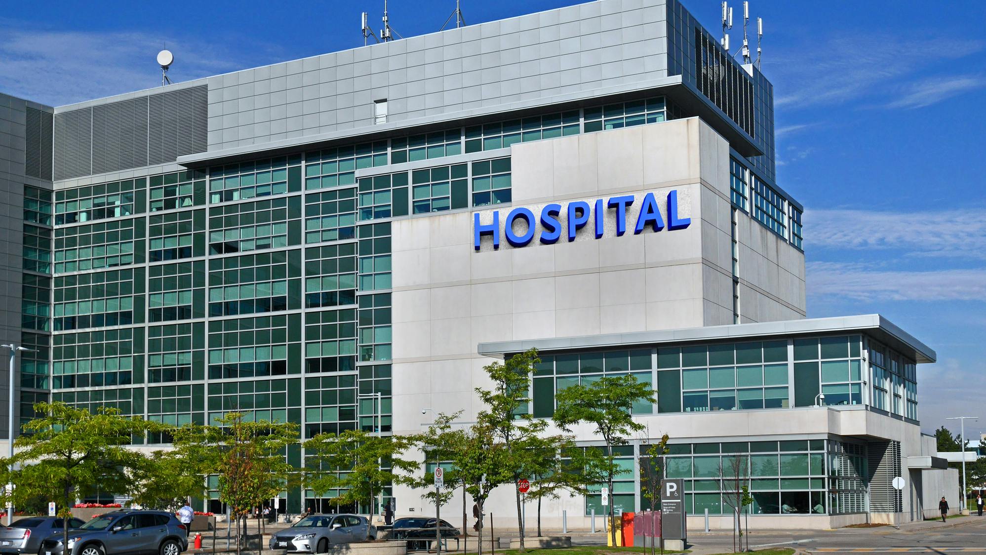

A new multi-story 400-bed hospital in a major city lost electric utility power. The hospital building is served by two electric utility feeders from different substations. A 27/47 relay in the hospital switchboard responded to the outage by transferring critical loads from one electric utility feed to another. The remaining utility feeder was heavily loaded, and the electric utility decided to reduce some of its load on this feeder to prevent a total blackout. However, this resulted in an outage of the remaining electric utility feed.
The hospital’s emergency automatic power transfer system responded by starting its emergency generators. Due to an error in the transfer system’s programmable logic controller (PLC), the system went into auto-fail mode, and the hospital was plunged into darkness. Fortunately, patient equipment with battery UPS systems allowed some critical life-sustaining equipment to continue to operate.
People were trapped in elevators; one of those trapped was a critical care patient en route from the emergency room to an operating room where they required immediate emergency surgery. Suction pumps, oxygen, medication, food delivery, HVAC, and fire suppression equipment were all compromised without power. The pneumatic tube system shut down, and a tube containing a blood sample taken from an infant was lost somewhere between the emergency room and the lab. Finding the tube was a priority, but there was no power to operate the laboratory equipment.
The hospital maintenance staff were overwhelmed. Eight automatic transfer switchboards on three levels were flashing “auto fail.” All had been tested per the manufacturers’ instructions as required within the last 30 days and seemed to be working properly. The electrician confirmed the generator was running and pressed the close button for the generator breaker, but nothing happened. An attempt was made to close the generator breaker at all eight boards, but none would close.
The fire department arrived and was confronted by the fact that the elevators were inoperable. A helicopter landed on the roof to move the critical patients to other facilities. The problem was how to get them to the roof.
Less than half a mile away, a high-rise court and correctional facility also lost power because of the same storm. Its backup generator started, and the load transferred. Five minutes later, the generator stopped, and the facility was dark. As required, the system has been tested monthly. The loss of power impacted electronic security and safety systems. Elevators were also inoperable.
The correctional facility's electrician manually closed the electric utility breaker, realizing the utility source was not available, and proceeded to restart the generator. He then attempted to manually close the generator breaker. It closed and immediately reopened. Because the electric utility breaker was closed, the PLC was tripping the generator breaker to prevent paralleling sources.
Follow-up investigations revealed that maintenance personnel (e.g., electricians) at both facilities were not properly trained. If the electricians had been properly trained, the power could have been restored to critical loads at both facilities.
