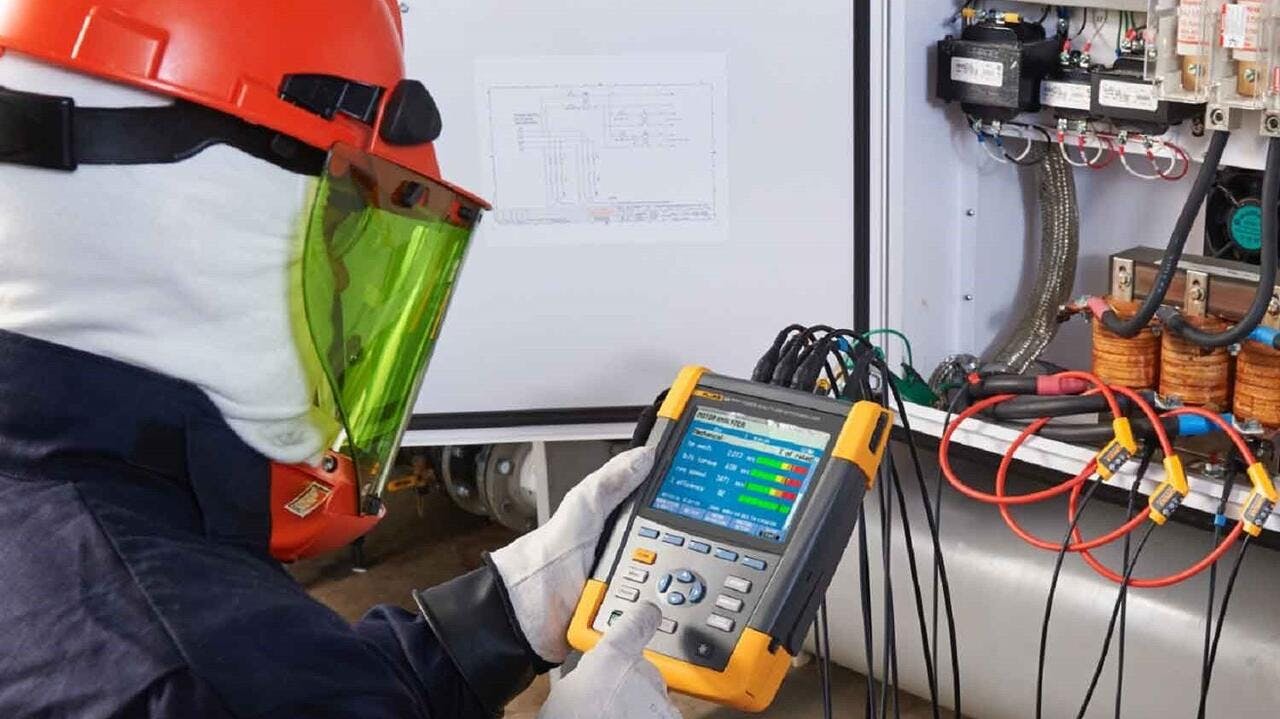

Tools that reveal the invisible
Unlike standard digital multimeters or clamp meters, identifying transients requires high-speed power quality analyzers capable of logging and capturing events at very fine resolutions. These tools allow electricians to:
  • Capture transient waveforms with sub-millisecond accuracy
  • Measure magnitude, duration, and frequency of each event
  • Correlate disturbances to equipment operation (e.g., motor startup, switching)
  • Distinguish internal vs. external sources by testing at different points in the system
The contractor sets up the analyzer first at the motor connection, then progressively upstream toward the service entrance. This step-by-step approach systematically narrows in on the root cause of the transient activity, ultimately allowing for the next step to occur: solutioning toward prevention.
