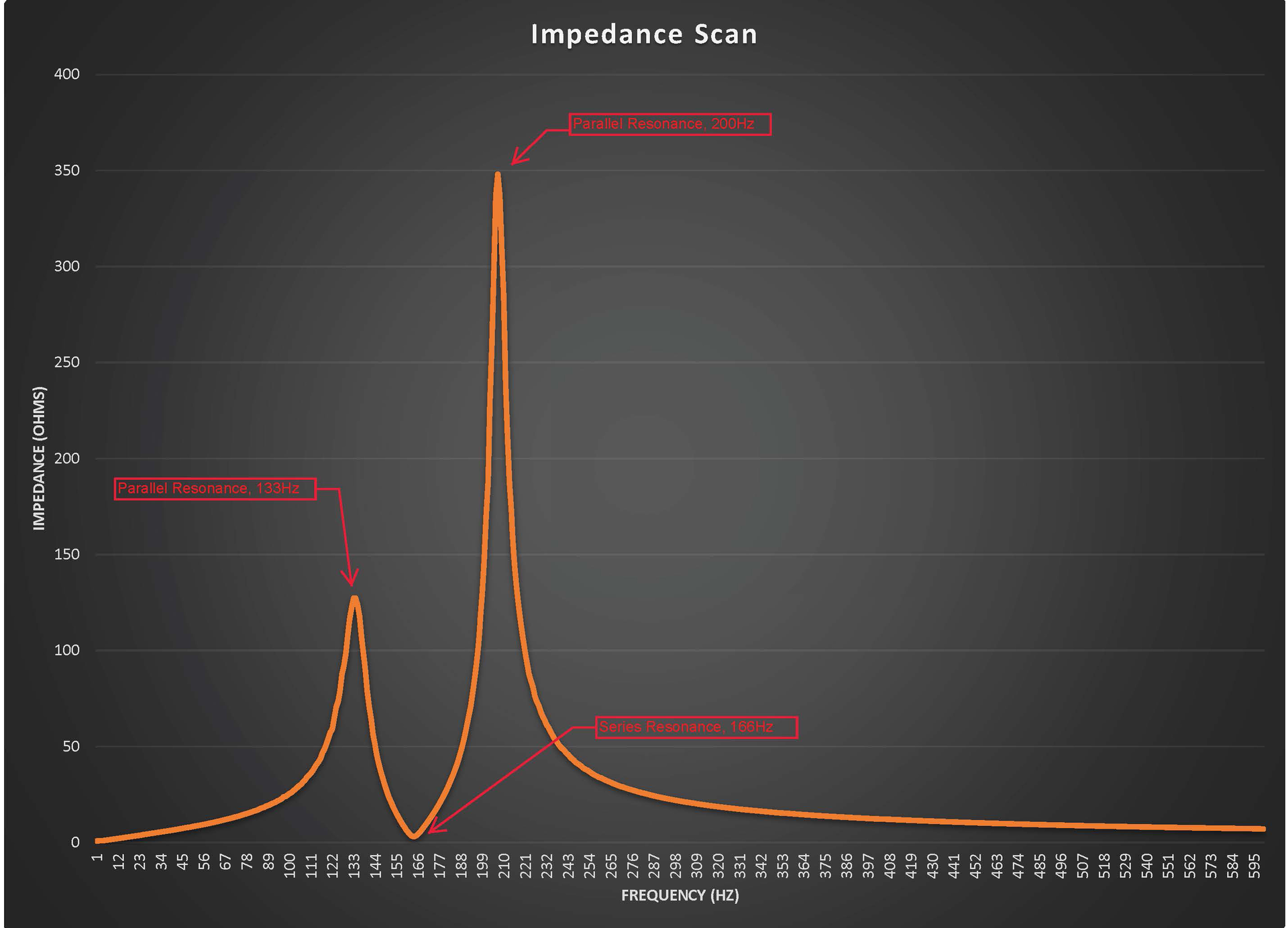

To identify where the resonance frequencies reside, perform an impedance scan on a simulated circuit, utilizing the aid of a software tool that performs this task.
The tool will inject a unit current at different frequencies and plot the circuit’s impedance as seen from the point of interest. This is helpful in identifying if the circuit topology will amplify the harmonic magnitudes and at which frequency. This information can be used to assist in detuning the circuit away from the resonance frequencies by way of harmonic filters. Another method is to reconfigure the circuit’s topography by moving the power factor (PF) correcting capacitors, or other devices, to a different electrical location on the circuit. This effectively alters the impedance values between the devices, which would shift the resonance frequencies. However, if there are no harmonic currents injected into the system, then there is nothing to amplify.
