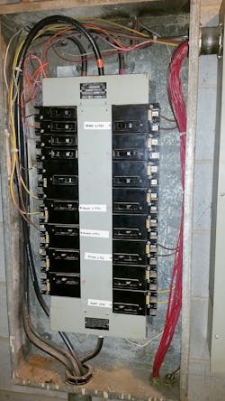

How does the quality of the EGC play a vital role in doing this for LED-based lighting systems? First of all, the EGC has to exist in the AC branch circuit. This allows the driver to have access to it. In fact, this is a major problem for older facilities where EGCs were not required in the lighting branch circuits.
The Figure above illustrates a typical installation in an older facility where 480V lighting branch circuits were originally installed to power a traditional HID-based lighting system. When a new electronic lighting control system was installed, it was grounded to the lighting distribution panel (LDP), which was part of the original installation. The LDP uses no grounding conductor back to the main switchgear. The LDP relies on established ground from a nearby cold copper water pipe. A ground conductor does exist from the LDP to the lighting control panel. However, no EGCs exist from the lighting branch circuit pull box (Photo 1) to the individual junction boxes mounted on the ceiling.
With this installation, the LED luminaires have to rely on the “grounded” electrical metallic conduit (EMT) system, which provides protection for the AC lighting branch circuits. The system is bonded to the lighting branch circuit pull box. However, EMT contains many mechanical joints. These joints rely on EMT fittings, which use compression rings and set screws to mechanically secure them in place. These joints do not establish a low-impedance bond between individual sections of EMT. The joints and fittings also do not establish a low-impedance connection with the lighting pull box or the lighting control panel. Regardless of how good the bond to the cold copper water pipe is, the impedance the LED luminaires see back to Earth is very poor.
In this era of electronic-based loads, which must sink leakage currents, emissions currents, and disturbance currents back to a low-impedance point (or Earth), this lighting installation cannot provide the low-impedance ground path to sufficiently ensure the LED drivers are protected from damage caused by electrical disturbances in a facility with poor power quality (i.e., facilities that use switching devices in their power systems and other electronic loads like variable-frequency drives). Electronic loads draw harmonics currents and are susceptible to transient voltages that cause transient currents to flow into the loads when their electronics are not properly protected. In these installations, it’s not the harmonic currents that are causing the problems. It is the emissions currents and disturbance (or transient) currents that are causing damage to the LED drivers when they cannot make it back to Earth through a facility’s electrical system, which relies on the metal/mechanical system of EMT to provide adequate low-impedance and high-frequency grounding back to Earth.
Again, it’s the laws of physics that are broken here. Electronic-based LED lighting equipment requires a high-performance bonding and grounding system to operate in electrical environments where electrical disturbances are a part of the normal common everyday electrical system.
