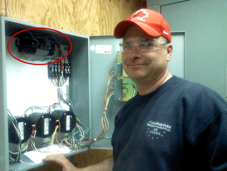

Frustrated but determined to solve the mystery, Claxton began looking at power quality instruments himself — something he could install permanently and use to monitor the power on a continuous basis. Upon the suggestion of one of his team members, he looked into a PQube from Power Standards Lab (PSL), Alameda, Calif. The PQube is a compact, low-cost power quality monitor with a DIN-rail mounting design. The device proved to be perfect for snapping inside the electric panel without much need for extra accommodation.
In addition to the low price and easy installation, the features that attracted Claxton to the PQube were its ability to monitor both AC and DC voltage and current at a 256 cycles-per-second sampling rate coupled with its ability to capture voltage dips and swells (both as waveform and RMS). In addition, the PQube monitors and records a number of other parameters, such as harmonics, unbalance, VARs, high frequency impulses and more, allowing for a detailed picture of power quality to be generated over time. The PQube’s data is delivered to an email or a server directly, in the form of graphs and comma-separated data files. No software is needed to open the files.
Most importantly for Claxton, the PQube could be monitored remotely, by installing an optional Ethernet module. It could also be set to send email notification alerts to up to five recipients, every time a power event occurs.
The combination Claxton purchased for the plant included the Ethernet module, as well as a power supply module and a current transformer interface. This configuration was installed at the primary service panel where it could monitor all the power coming into the plant. Installation and setup took less than 2 hr — and the monitor emailed its first event notification to Claxton that same evening.
