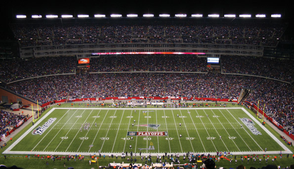

When you’re attending a game or watching it on television, the last thing you think about is the lights going out. We certainly never thought we’d witness a power outage at the nation’s biggest sports event of the year, but while watching the third quarter of Superbowl LXVII on Sunday, February 3, that’s exactly what happened. After a large group of HID light banks suddenly went out, fans, officials, crews, and players were left in near darkness for about 34 minutes.
Hundreds of reports as to why the lights went out at the Superdome in New Orleans were released into the media, and commentary flooded the Internet. One report stated that electrical equipment connecting the stadium to the electric utility was replaced in December — and that the problem didn’t appear to be related to that equipment. Metering at the Superdome indicated nothing more than a normal load during that game. Another account stated that Superdome officials were concerned about the facility’s electrical system months before the game. Many vital repairs were made, but not all were able to be completed. Testing of the feeders that power the stadium indicated some power quality problems. Ultimately, protection relays on the power feed to the stadium detected the problem, and automatically shut down the system. No matter what the culprit was behind this outage — whether it stemmed from faulty equipment, improper maintenance, or human error — the bottom line is this outage caused a severe interruption to the game and significant impact to the financial success of the event.
Losing power at a high-profile sporting event can bring intense post-outage scrutiny from many different organizations (Steve Broer/Shutterstock.com).
