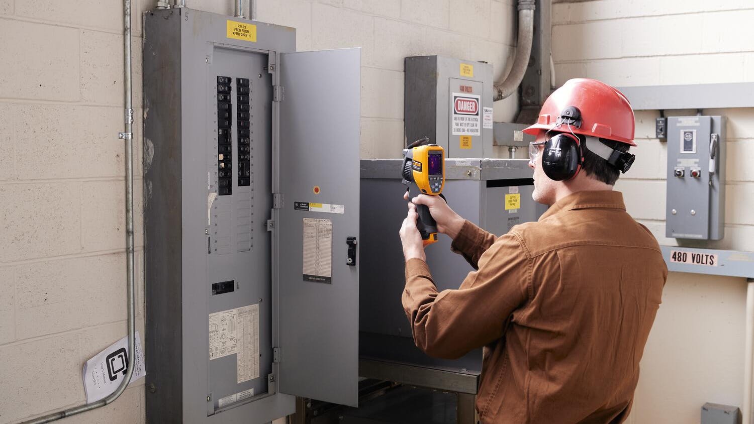

  2. Once the location or locations of possible electrical problems have been identified, inspect the electrical panel for loose connections — either by using a thermal imager, visually, or by de-energizing and securing the panel to check proper torque. Correct any loose connections found.
