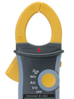

The CW10 clamp-on power meter combines the functionality of a standard clamp-on tester, digital multimeter, and power monitor
Nov. 18, 2011
The CW10 clamp-on power meter combines the functionality of a standard clamp-on tester, digital multimeter, and power monitor to diagnose maintenance and electrical issues. The meter allows users to measure 600A AC/DC, 1,000VAC/DC, 600kW AC/DC, power factor, total harmonic distortion, harmonics from 1st to 25th, resistance, and frequency. Other measurement and diagnostic capabilities include phase rotation, voltage detection, continuity check, diode test, inrush current and low pass filter. In addition, the product features a joystick that allows users to select the preferred diagnostic function. The display is backlit when clamping and contains a 3.5 digit and bar graph display.
