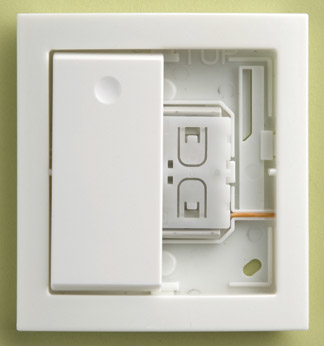

Each controller can manage up to 10 loads, and is hardwired to line voltage and to traditional lighting fixtures and receptacles. For the average 3,000-square-foot home, this means four or five controllers are required. The number of switches provided depends on how many the homeowner desires. Switches can be programmed to operate one light, several lights, or every light in the house, giving users the ability to set unlimited lighting scenes as well as pathway lighting.
“In essence, every switch functions like a remote control,” explains Pisarek. “They are manufactured with a docking plate on the back, which can be screwed, nailed, thumb tacked, or even glued to a wall. Furthermore, they can adhere to any surface, including glass, brick, stone, tile, and wood.”
In addition, each switch can operate as a dimmer. Compared to a traditional residential electrical system, the company says the product requires less copper wire and eliminates the need for wall boxes, wire connectors, and conduit (if required) associated with traditional hard-wired switches. The system also supports switched outlets, which simplifies turning off power to phantom loads, such as computers, stereos, and DVD players.
