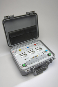

The portable SD300 is a long-life battery-powered tester
Nov. 19, 2007
The portable SD300 is a long-life battery-powered tester for use in situations with 1,000VDC and a maximum capacitance of 1,200uf. UL-listed, the device incorporates a two-handed push-button operation to initiate and maintain the energy discharge. According to the company, users are isolated from the discharged energy by a fully insulated and robust instrument case rated at IP66. In addition, it is available with fully shrouded test leads as well as an inbuilt test lead and fuse proving facility. Other product features include an automatic pre-use self test, protection against prolonged connection to live operating circuits, and monitoring of critical component temperatures with automatic cutoff.
